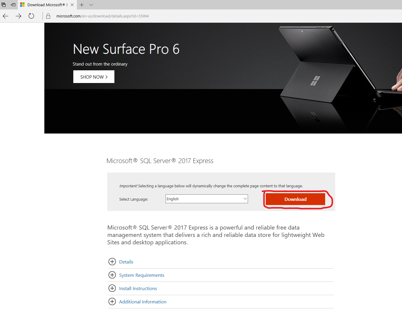

First thing we need to do is to download Microsoft SQL Server Express from the official site:
Download Link.PNG (289.47 KiB) Viewed 5037 times
As of today's date (28/12/2018), a valid download link for the Microsoft SQL Server Express is:
https://www.microsoft.com/en-us/downloa ... x?id=55994

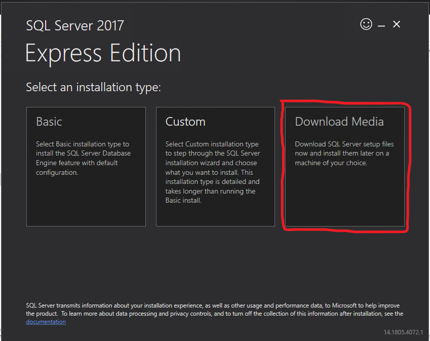

After the download has successfully ended, open the "SQLServer2017-SSEI-Expr.exe". After doing so, you will be prompted to choose between an installation type, as in the following screenshot. Here, you need to choose "Download Media":
Download Media.PNG (144.88 KiB) Viewed 5037 times
