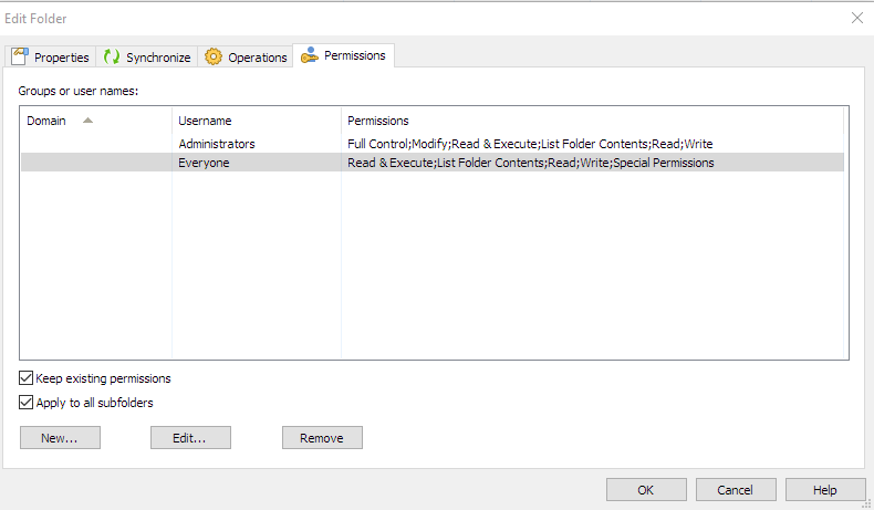

Using 14.3, I cannot set permissions on an installed folder for all users. The installer hangs, and never completes.
The folder is intended as a cache, and any user should be able to update all files within.
The folder is installed under 'Common Application Data', so somewhere under C:\ProgramData\CompanyName\App\
I can install the folder just fine, but when I add permissions, the installer fails.
How do I successfully configure an installed folder to enable write access to all users?

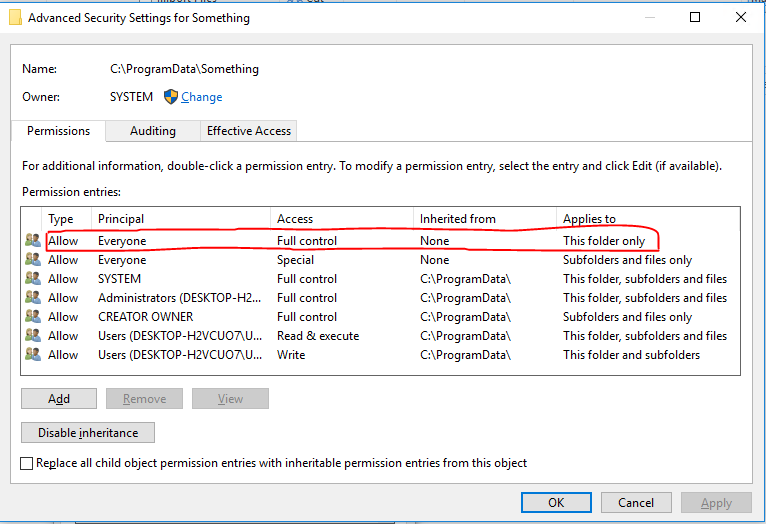

Also, how do you verify if the permissions were correctly set? Did you go to the folder's location, right click on the folder -> "Properties" -> "Security" tab like in the attached screenshot?
If that is the case, indeed, you may not see the permissions for "Everyone". However, if you click on the "Everyone" group and then click "Advanced", you will notice the permissions there like in the following screenshot:
