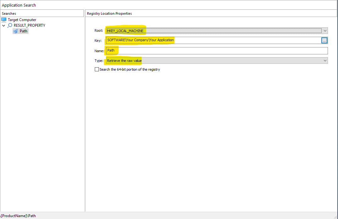

2. go to "Search" page and:
2.a) create a new search by right clicking on "Target Computer" --> "New Search"
2.b) now click on the earlier created search --> "Add search location" --> "Registry"
If a basic project (where Manufacturer=Your Company and ProductName=Your Application), the search can look like this:
Annotation 2019-09-10 104259.png (21.62 KiB) Viewed 14611 times
