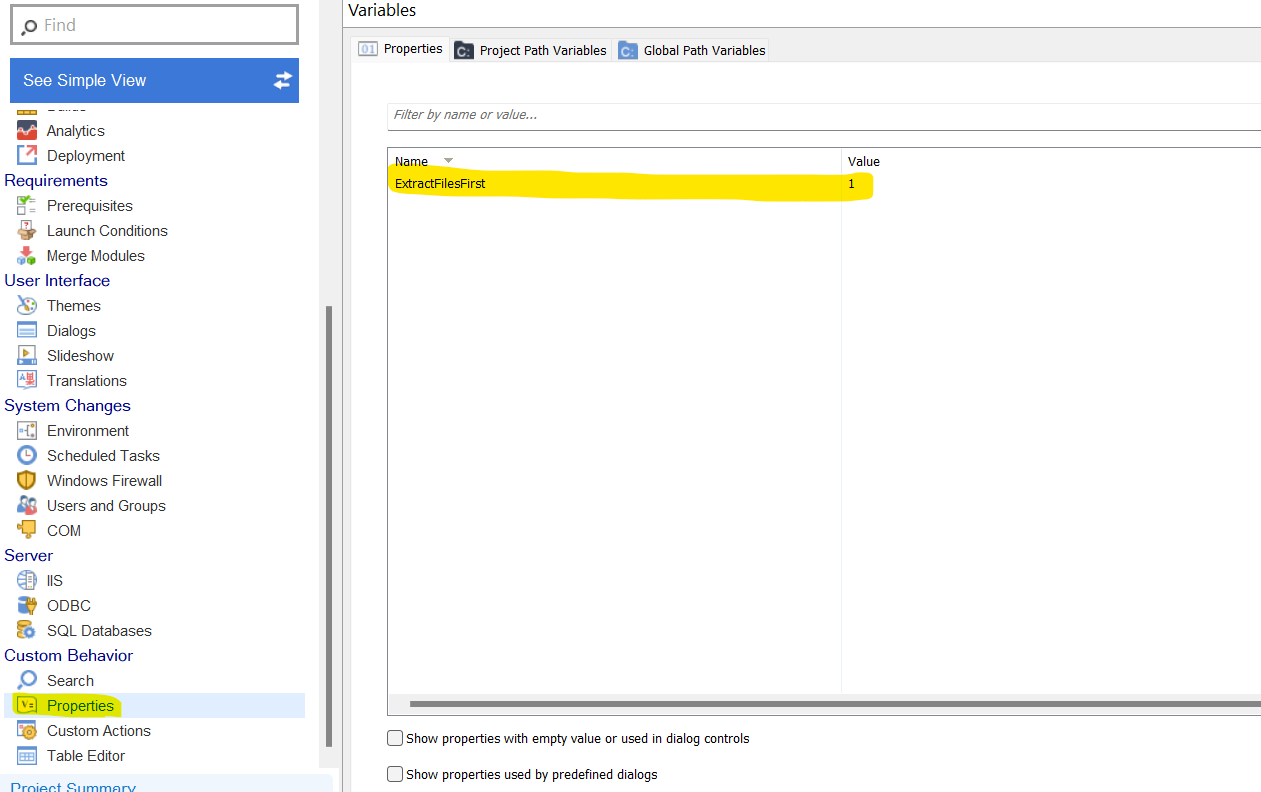

I am in the same position as this post describes. I am using Advanced Installer Version 20.4.1.
Can you let me know the steps to add the ExtractFilesFirst property to the Install Parameters page please?
Posts: 1419
Re: Source File Not Found ????
Please note that in the latest versions of Advanced Installer, the properties have their own entry in the left menu.
Just above the Custom Actions you can see the Properties view, being more clear and much easier to work with them.
Therefore, you can add the ExtractFilesFirst property from the Properties page:
properties page.png (65.41 KiB) Viewed 32385 times
PhilipDunn
Posts: 2
Joined: Wed Mar 15, 2023 1:41 pm
Liviu, that worked perfectly. Thanks for the prompt reply and excellent support.
