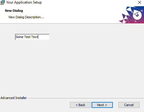

On the first Dialog i have a TextInput.
The users types in "TEST"

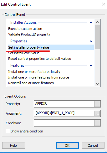

- first of all, it is important that the dialog where the user inputs the text is scheduled before the "FolderDlg"
- after that, what we can do here is to create an event which will set the APPDIR to APPDIR\<whatever_the_user_inputs>
- to do so, please go to "Dialogs" page --> select "FolderDlg" --> "Init Events" tab and create an event as it follows:
where the [EDIT_1_PROP] is the property assigned to the editbox control (I underlined it in the first screenshot).

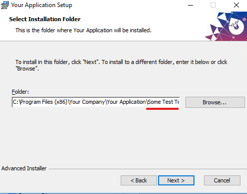

After doing so, when running the setup, the APPDIR property will correctly be set to the expected value - APPDIR\<user_input>
