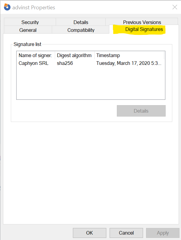

When I right-click my executable installer file I do not see a Digital Signatures tab. This leads me to think that the .exe file is not signed. Below is screenshot link.
https://www.dropbox.com/s/mmxjx57pqgcet ... t.png?dl=0

From what I can see, there isn't indeed a "Digital Signatures" tab for your executable file.
However, could you please repeat this scenario with your MSI and let me know if the result is the same?
