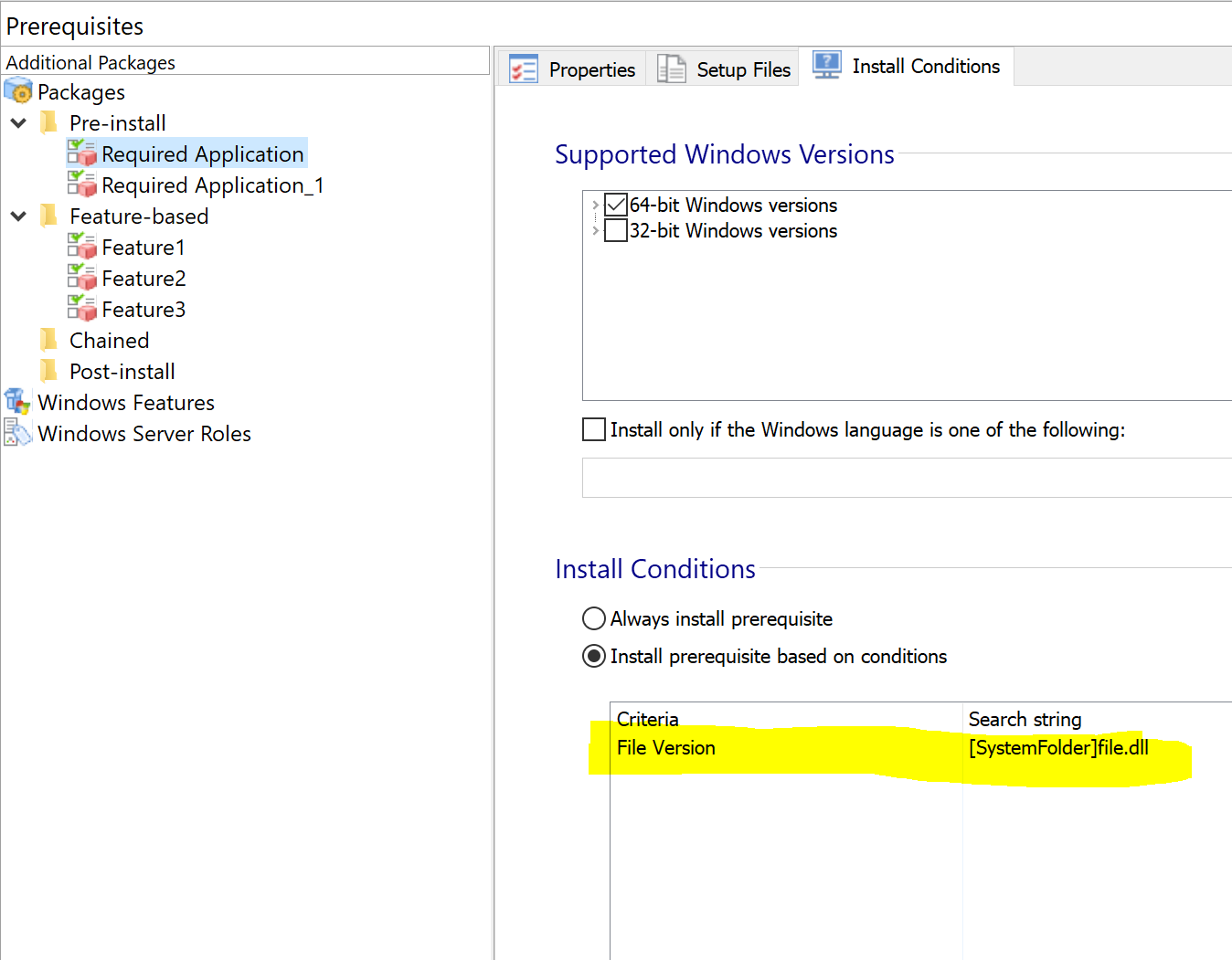

As I can see, one of the Pre-Install prerequisites have this install condition:
By the way, in the sent sample, one of the Pre-Install prerequisite is a .MSU file. Maybe Windows requires a reboot after installing that Windows Update. Can you please check if this is your case?

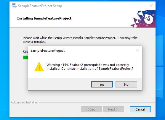

Can you please attach a printscreen with the erorr that you have during installation? Also a log file will help us a lot to have a better view about this. To crate a log, please check the how do i create a log article.
When you get that Warning 4154, can you please check if the prerequisite was correcly installed?
If the prerequisite was correctly installed, then the problem is with the install detection criteria that you have defined in the installer.
Maybe the prerequisite fails to install, thus the error message is correct.

Thanks for the reply, I get that 4154 error while installing the main package. I have also checked by installing stand alone pre-requisite, it correctly installed on my machine. But whenever i am trying to install any of the Feature msi from SampleFeatureProject.exe it gives me error of 4154.
I have attached the LogFile and screenshot of that error with this post.

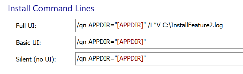

To see why the prerequisite was not installed, please pass the following command line to the prerequisite:
prereq feature props.PNG (11.98 KiB) Viewed 64891 times
This should create a log file on C:\ drive that should give us more details why the feature 2 prereq is not installed.
