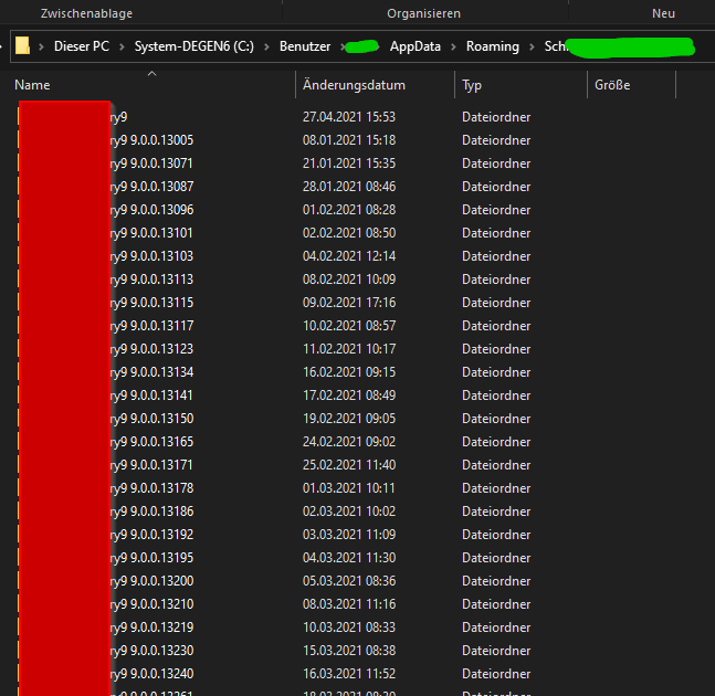

I think I encountered the same issue. If I understood correctly @frankmanguiob did not say that the files are being kept, but a lot of empty folders. At least this is what I encounter. For every installed Version, I have a folder with the name of the version and this folder only contains one folder called "install". This folder itself is empty.
I don't have the option "Do not deleted extracted CAB and MSI files" enabled and those files are not being kept. However there are a lot of empty folders. For me, it looks like those empty folders also should be deleted after the setup.

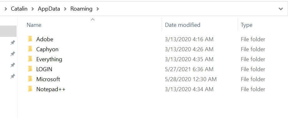

Are you sure that this folder was deleted after setup? Did you look for the right company name?
Yes, I have been looking for the "Product Details" page --> "Publisher" folder.
Here is a screenshot before installation:
And here is a screenshot after the installation:
As you can see, the folder is correctly removed.
