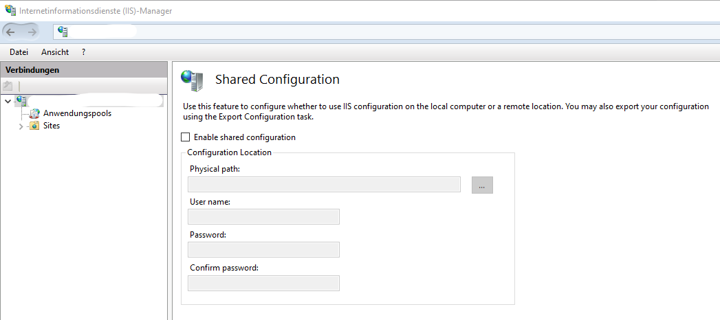

I just managed to reproduce this on one of my local, virtual test servers. These are the settings for the shared configuration, that lead to the failure:
When mapping the share to a local drive letter instead, it would work. Using a network path like in the screenshot, it won't.
