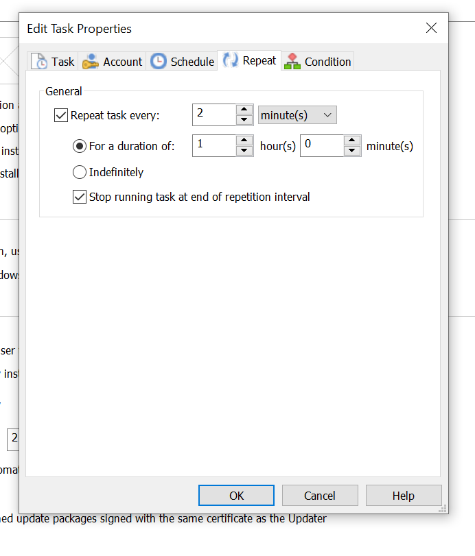

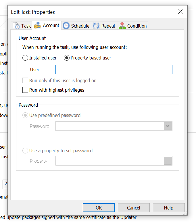

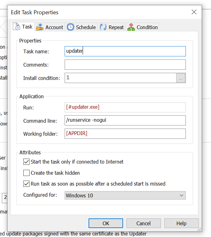

I want to run my updater as a service which checks for updates every x minutes and installs them if there are any. Currently I've configured the updater as shown in the screenshots. However, The updater doesn't get invoked automatically. Can someone please help me out?

Thank you for the provided screenshots.
From what I can see, the command line is missing the "/silentall" parameter, which should search silently for updates and automatically install all updates.

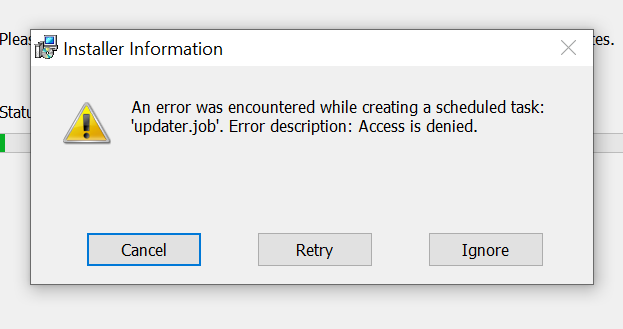

Thanks for the response Catalin, It works fine when I use /silentall -nofreqcheck commandline when my install type is "Per machine only (fail if user is not administrator)". With "per-user only" install type it shows the below dialog while installation of MSI. How can I make it work with "per-user only" ?
Unfortunately, as also stated in our article, this will work only for the "Per machine (fails if user is administrator" type.
Please note that the two operations (creating/configuring a Windows Service & creating/configuring a Scheduled Task) require administrator privileges, therefore your setup will not be able to create those if the user is not administrator - as stated in your screenshot, the access is denied.
