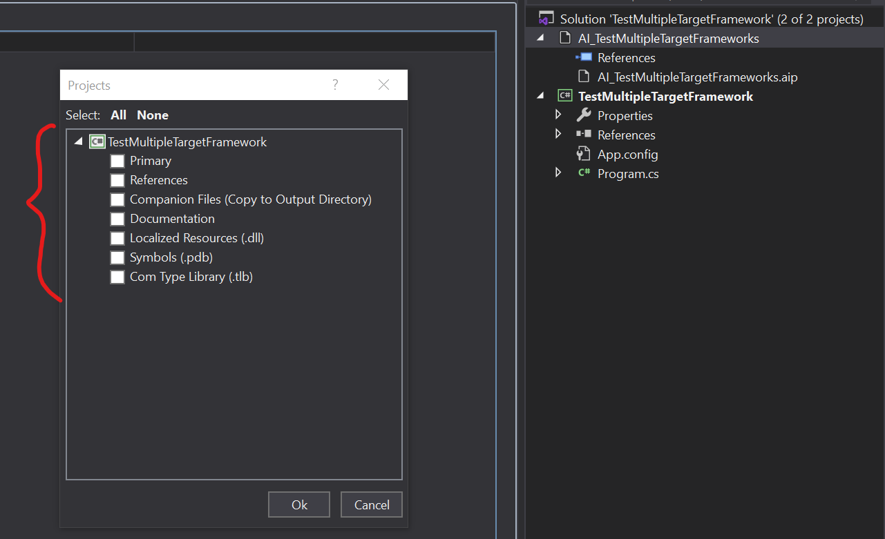

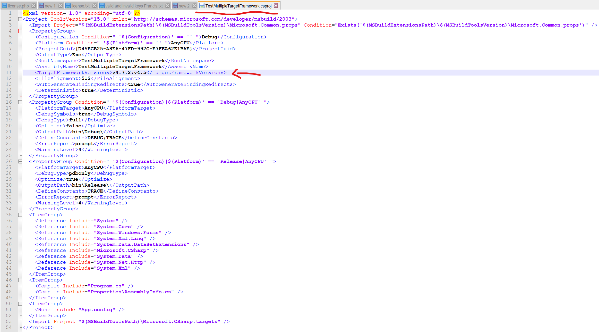

Empty "Add Project Output" window in Visual Studio
The popup window is empty when your visual studio solution has at least one project that uses multitargetting (TargetFramework-s-, instead of TargetFramework). The behaviour returns as expected after removal of these projects or updated project configuration.
Due to issues with 3rd party dependencies we multitarget our common projects so single targetting isn't really possible in our case.

Hi Catalin, Thank you for your elaborate reply.
I have revisited Advanced Installer and noticed the same error still exists.
My suspicion was misguided; there is indeed no issue with the TargetFrameworks property, as you demonstrated. But there is an issue when at least one of your visual studio projects uses the new SDK-style project layout.
This layout is automatically chosen when you create projects targetting NetCore or the new Net5.0 (which is basically .net core 4.0).
This is at least an issue on my end. Maybe it's not a general issue.
But I'm surprised because .net core projects should work as expected (i browsed the forums and since january 2021 there should be support). I try to keep my program installations as default as possible.
This might be an issue with documentation too. The getting started with AI and Visual Studio starts from an already existing solution, but it neglects to mention which visual studio version, which framework the projects are targetting and which project file layout is used.
Re: Empty "Add Project Output" window in Visual Studio
Hello Bert,
You are always welcome!
Regarding the new issue, I have tried testing this and everything seemed to be working as expected on my end. Truth being told, it's been quite some time since my last reply and perhaps something has changed in the meantime - I am testing using version 18.8 (our latest version).
So here is how I tested this:
- in VS, create a new .NET Core project
- set the Target Framework to .NET 5.0 as specified by you
- add a new Advanced Installer project to my solution
- open the project --> "Files and Folders" page --> "Add project output". Here is how the window looks like:
After clicking "Ok", the files are added to the project, as expected.
If possible, could you please forward me a step-by-step test case which I can follow in order to reproduce this issue on our end?
