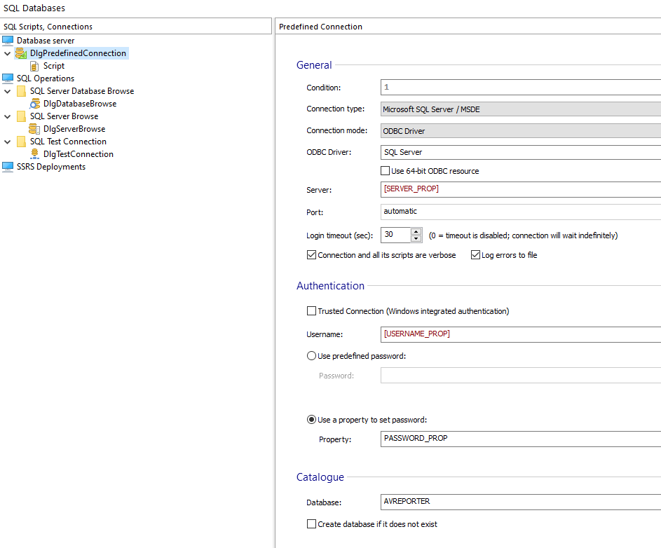

For me this will be fine, but what is the easiest way (settings) if I would like execute an SQL script at the end of the installation and the connection string is coming from AI variable?
Thank you!
Re: Execute SQL Script after IIS AppPool installation
Hello László,
I am glad you managed to solve the .NET issue.
Regarding your question, please note that the SQL scripts are running during "Install Execution Stage" -> "Add Resources" (On deferred)
If you want to execute it at a later stage, then you could use an "SQL Query".
The main difference between an SQL Script and an SQL Query is the fact that the query can be manually scheduled.
Using an SQL Query to interrogate SQL databases
