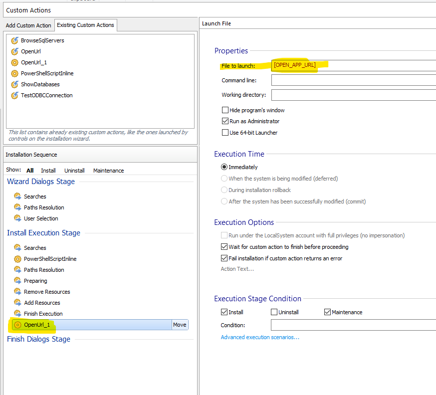

To affect a property used in a condition on a component or feature, the custom action must come before the "Paths Resolution" action group from "Install Execution Stage". Your custom action which changes the value of the property was after the "Finish Execution" stage.
Just move your "PowerShellScriptInline" custom action before "Paths Resolution":
Also, delete the "Open URL" custom action from the "Published events" of the "Finish" button in the "Dialogs" page --> "Exit" dialog.
Now add a "Open URL" custom action with sequence after the "Finish Execution" stage and configure it like this:
Attached is your sample project with the above modification. After I tested this, the localhost URL saved from the first version of installation was launched.
Let me know if that helped!

Another thing why I'm placing OpenUrl on the finish button is because if I place in Install execution ->finish the stage, before (in the official installer this was the only example) open URL I have a script that checking and waiting services to be run and in Open URL is executed before the previous script ends and I have situation service is not jet ready but open URL script is executed.
