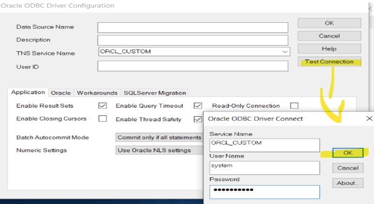

II. For troubleshooting purposes, to double check and test the ODBC connection string you can also use the “ODBC Data Source Administrator” manager of Windows OS. Just proceed like this:
1. Open “ODBC Data Source Administrator” and go to “System DSN”
2. Add a new system dsn and select the Oracle driver -> Finish
3. Fill in the “TNS Service Name” field with the name of the TNS Service you want to use (check the content of OracleHome\network\admin\tnsnames.ora file)
4. Use the [Test Connection] button and fill in your TNS service name, username and password -> click [OK] and you should get a “Connection successful” message
