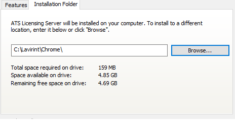

Hi thanks for the answer we don't want to use another control we want to achieve this:
but without using another control, the problem is that when the folder is changed variables are not updated, and for now, I don't have any idea if that is possible without control and only using labels (default browse dialog) with [PrimaryVolumeSpaceRequired], [PrimaryVolumeSpaceRemaining],[PrimaryVolumeSpaceAvailable] and without going forward-backward on installer.
