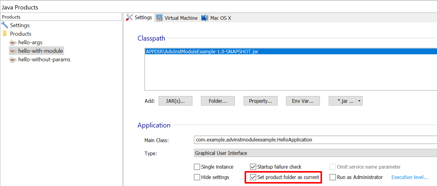

I have followed up with our customer over the email for this, but in case anyone else will be stumbling upon this issue in the future - the problem was how the parameters were passed to the JVM, e.g.:
the user was passing them like this:
--module-path jfx/ --add-modules javafx.controls,javafx.fxml --add-exports javafx.graphics/com.sun.javafx.tk=ALL-UNNAMED
while they should have been passed like this:
--module-path=jfx/ --add-modules=javafx.controls,javafx.fxml --add-exports=javafx.graphics/com.sun.javafx.tk=ALL-UNNAMED
Additionally, if you want to launch the executable through a shortcut, please make sure you check the "Set product folder as current" from the "Java" page --> your product --> "Settings" tab.
