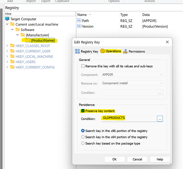

To preserve your registry key during upgrade you can right click on your key --> Properties --> Operations tab and check the "Preserve key content" option with the "OLDPRODUCTS" condition.
reg key.png (137.27 KiB) Viewed 9901 times
