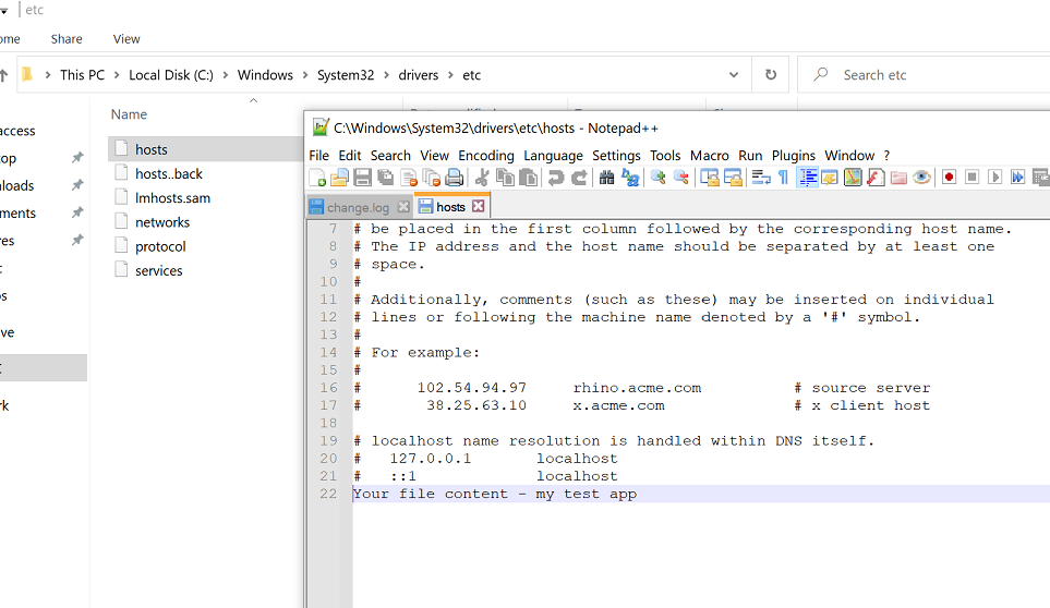

Please find attached a sample project.
After you build and install the package, the hosts file will be successfully modified:
hosts sample.aip
(21.61 KiB) Downloaded 508 times

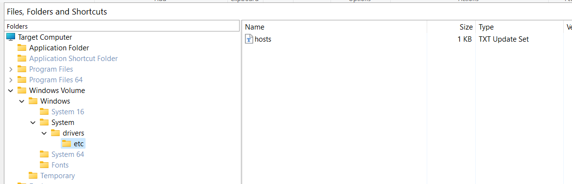

But how do I make it work on 32 bit system?
Posts: 1420
Re: I'm not able to add a line to hosts during installation!
It worked!
Thank you very much!
You're always welcome!
For this you can try to add your Text File Update on the System folder.
