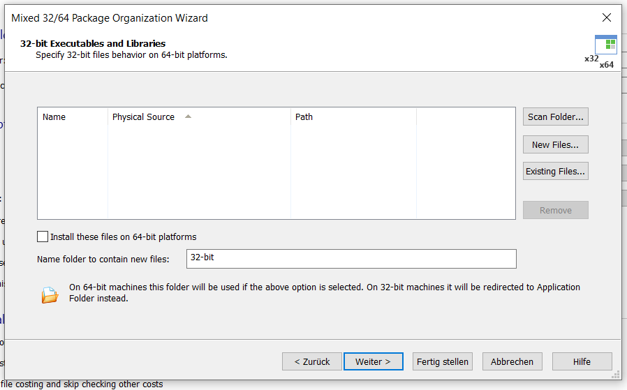

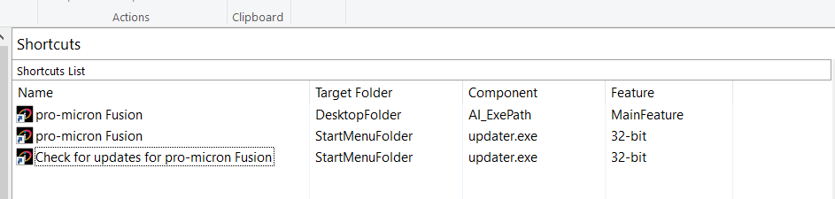

I am trying to add a shortcut to my software's updater. I am using mixed 32/64 (package type in install parameters). The problem is that the shortcut to the installer is only working for 32 bit.
I used to build for only 32 bit, and everything was working. Back then, the shortcut appeared in "32-bit executables and libraries" in the package organization wizard (screenshot of this page included).

Shortcuts page
Shortcuts page
Back when I built for only 32 bit, the shortcut appeared in "32-bit executables and libraries" in the package organization wizard.

Thank you for sending us your project file. I've looked over it and I noticed that the updater executable and its shortcut are only added in the "64-bit" feature from the "Organization" page.
For example, if you select the shortcut file in the "Files and Folders" page and press the "F8" keyboard button, you will be redirected to the related component from the "Organization" page. Since that component is only added to the "64-bit" feature, its resources will only be installed on a 64-bit machine.
To have the updater and its shortcut installed on both the 32-bit and 64-bit machines, you can drag and drop that component to the "Common" feature.
