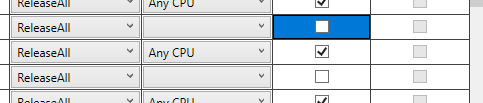

Some steps to reproduce:
- open the SLN in VS2022 (17.6.3 Enterprise edition),
- close all opened windows/tabs
- make sure the two .aiprojs are not selected in the build configuration:
Screenshot 2023-07-06 115716.png (8.36 KiB) Viewed 13510 times
- save the SLN changes
- close and re-open Visual Studio
- verify that the .aiprojs are not selected - they are not
- open one .aip in Visual Studio by double-clicking it in Solution Explorer
- the .aiproj is selected again:
Screenshot 2023-07-06 120556.png (9.73 KiB) Viewed 13510 times
