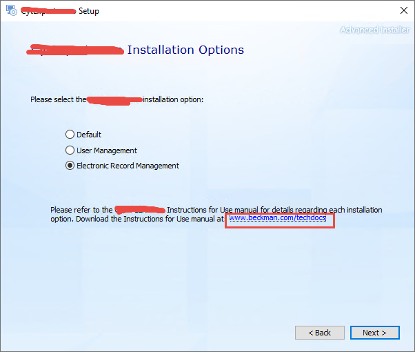

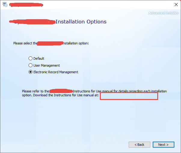

Hi Team,
I have a hyperlink in my page which is behind a Label control.
In the process of running the installation program, this hyperlink " " will not be displayed, and the hyperlink string will only be displayed after clicking the location of the hyperlink.
What properties need to be set to ensure that hyperlinks are always displayed?
Andrew
Click before.png (125.67 KiB) Viewed 15233 times
Click After.png (130.12 KiB) Viewed 15233 times
Re: Hyperlink string not showing
Hello Andrew,
This might happen if you placed the hyperlink control under (behind) the Text box, something like in the following screenshot:

I set the hyperlink to "Bring To Front" and it still doesn't show. You still need to click the hyperlink once before it is displayed.
