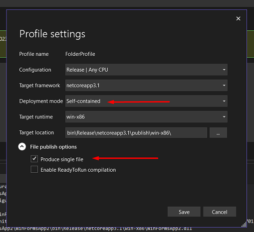

You need to build your application as a single EXE output file.
In order to achieve this, please take a look at the Single-file deployment and executable article.
single file.png (49.92 KiB) Viewed 7699 times
