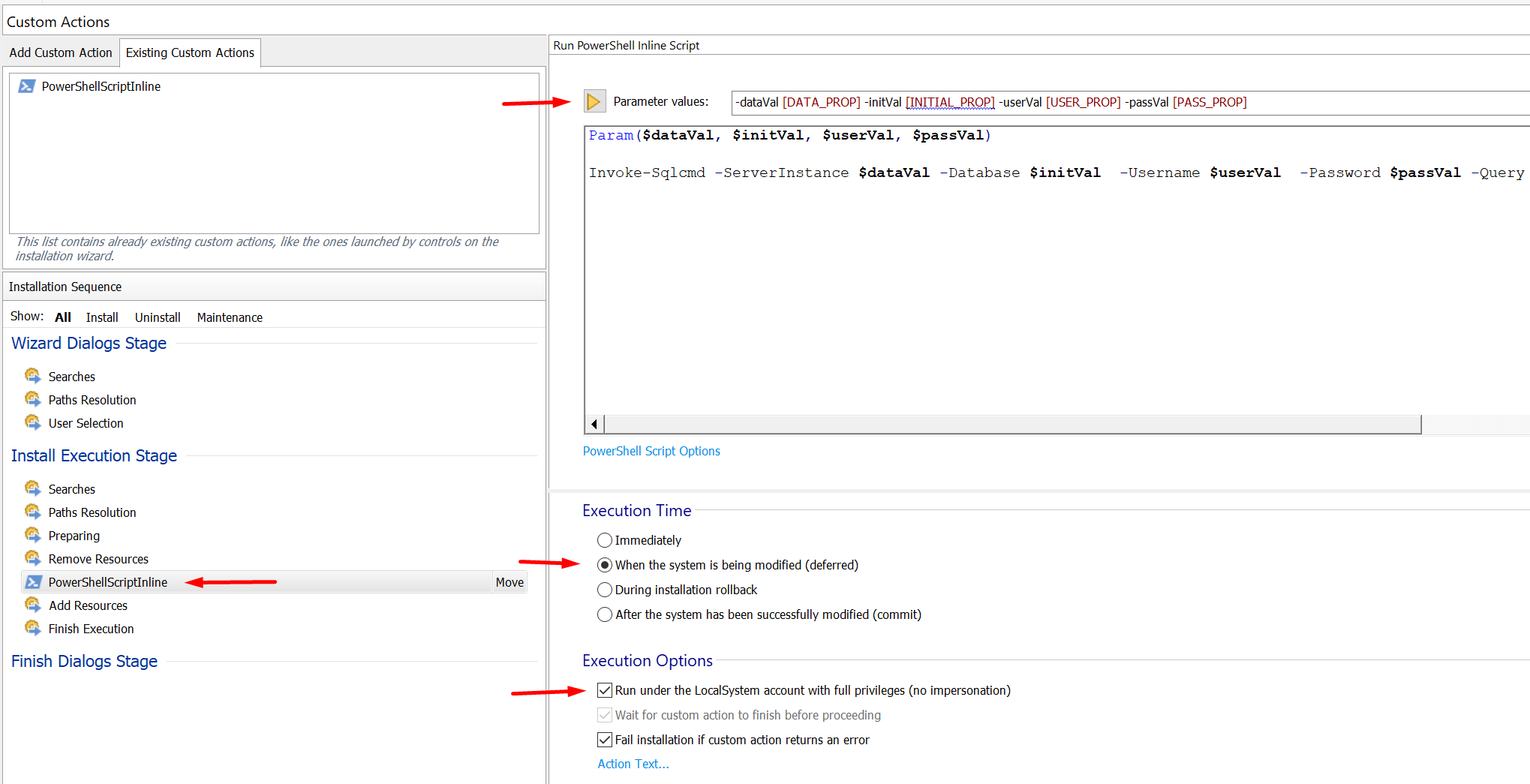

Most likely, in your case, the properties are not available during the uninstall.
If you want the value that your user inputs at install time to be available at uninstall time, you can try to set the properties as "persistent".
How do I make the properties in the package keep their values during Maintenance or Upgrade?
Additionally, since your custom action modifies the system, you may want to schedule it as "deferred" (its "Execution Time")
If your custom action requires elevation, you can also check the "Run under the LocalSystem account with full privileges (no impersonation)" option.
Here is how your custom action can look like:

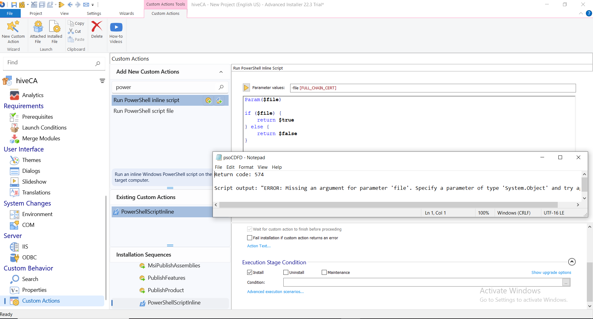

I want to access a searched file in my shell script, I ran search test and it was able to locate the file in the target computer. Property name is "FULL_CHAIN_CERT" and file type is .pem, how can I access the file in custom action's Run Powershell inline script.

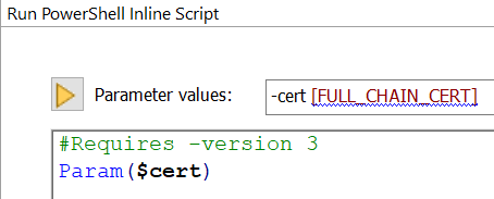

2. if the custom action is set on deferred, we can proceed like this:
If the name contains spaces, we have to enclose the property between double quotes, e.g.:
-cert "[FULL_CHAIN_CERT]"

I tried both the approaches, I am getting error in script output saying
"ERROR: Missing an argument for parameter "file". Specify a parameter of type 'System.Object' and try again..."

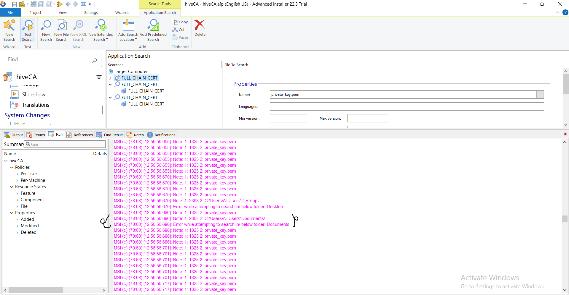

Also, in "Application Search" in custom behaviour, when I am testing the file search operation "test search" it is able to find the path of the file correctly but when I run the installer, I see an error in the logs saying,
"Error while attempting to search in/below folder. FOLDER_NAME."
For every folder it is searching for in.

Re: PowerShell Inline Script
Hello Rohan,
Please note that your powershell script relies on a search, which is not executed when you use the "Test Script" button.
Instead, you should be testing the entire installation package by running it - preferably on a Virtual Machine or in Windows Sandbox.
This way, the search will be executed first and then the PowerShell script based on that.
