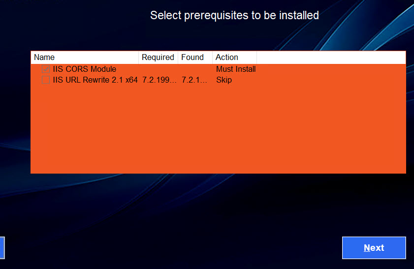

I've built an installer based on the Orange Vivid Theme but do not want anything to be orange.
I've had good results of all other dialog entities using AI_CONTROL_VISUAL_STYLE but it doesn't apply to the PreRequisite picker (it seems).

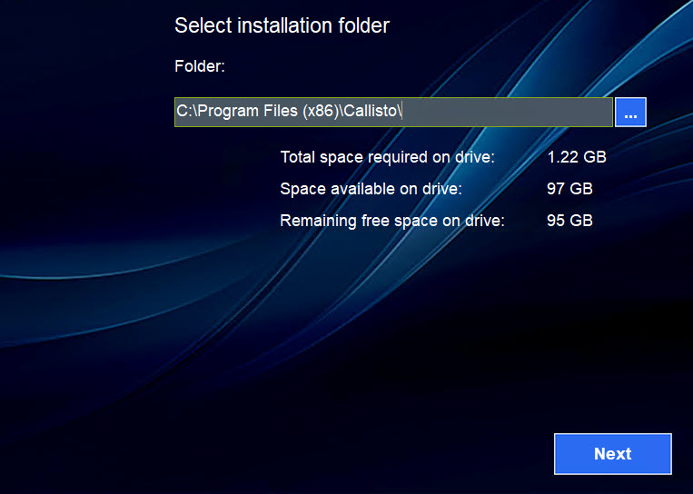

I've attached a screenshot of the problem and a screenshot of a correct color textbox being set with AI_CONTROL_VISUAL_STYLE.

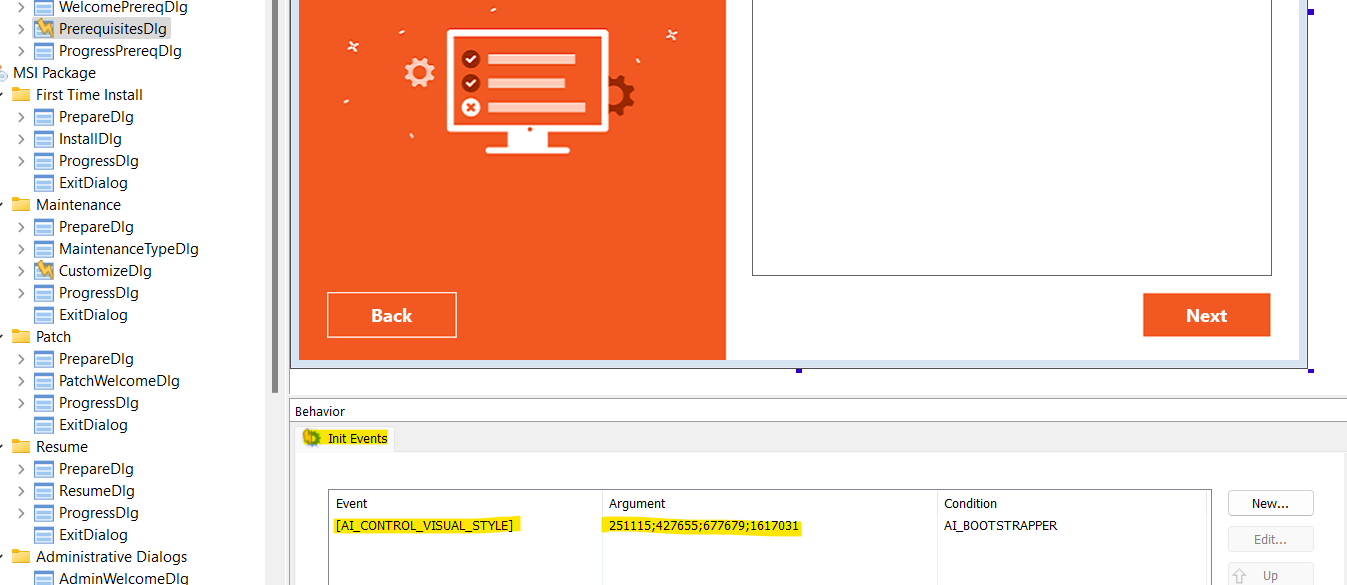

Or, you can add the Set installer property value event on the Init Events of the PrerequisitesDlg dialog:
init events.png (68.45 KiB) Viewed 5358 times
I hope this is helpful!

Works like a charm! Many thanks for the quick reply.
