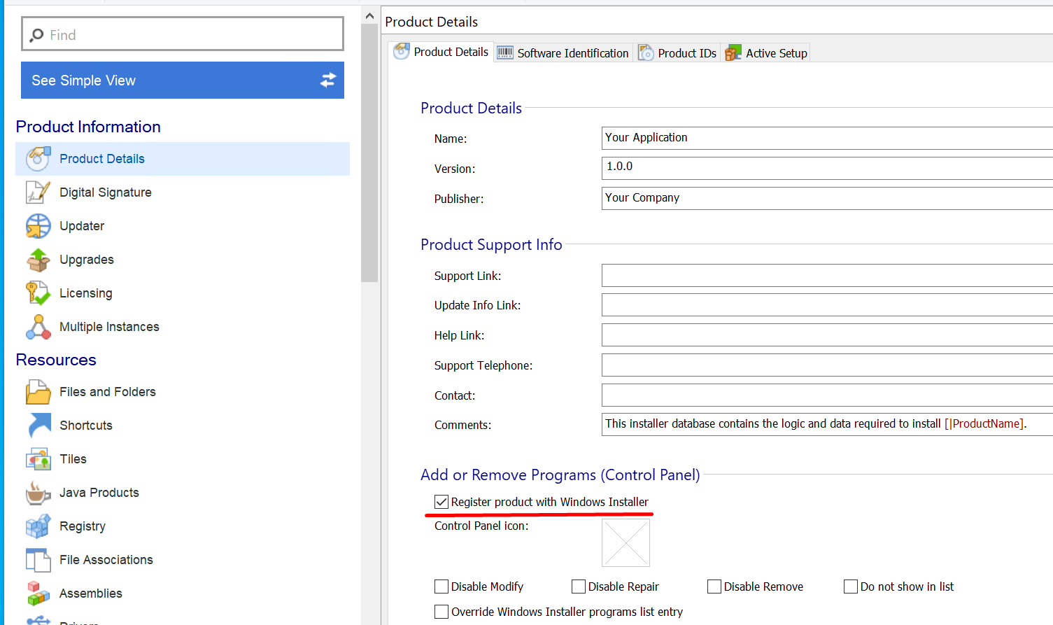

Hello Luka,
You are always welcome! :)
We can easily get rid of the "phantom" app from the Control Panel by unchecking the "Register with Windows Installer" option on our "bootstrapper" in the "Product Details" page:
This way, our bootstrapper should no longer appear in the Control Panel.
In addition to that, to make things even cleanier, please go to "Registry" page and remove the entries from there. There are some entries that we create for every project.
