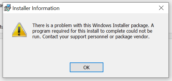

When I build my installer as a Single MSI and run the installer my Launch installed program custom action appears to be failing:
When I build the installer as a Single EXE setup the custom action works fine.

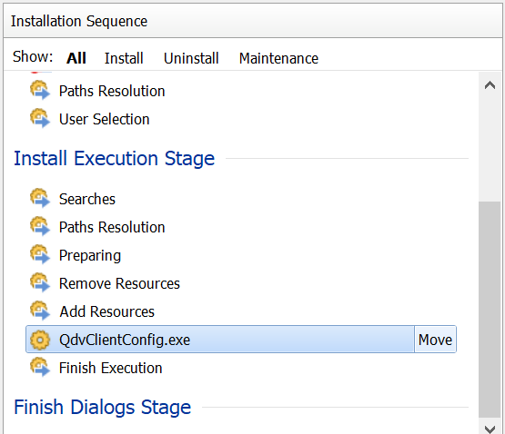

Below is the custom action I am trying to execute. It is called at the end of the Installation sequence.

When do you schedule the custom action? Please note it should be scheduled after the "Add resources" action group, with its' "Execution Time" set to "When the system is being modified (deferred)".
In your case, I see that it is scheduled as "Immediate" which happens before the files are actually copied on the disk.

Catalin wrote: ↑Fri Apr 28, 2023 11:35 am Hello,
I can't really say why this is happening.
I scheduled the custom action after 'Add Resources' and before 'Finish Execution' and set the execution time to 'When the system is being modified(deferred)' but I am still getting the same behavior. However if I choose to build as a single exe it still works fine.
