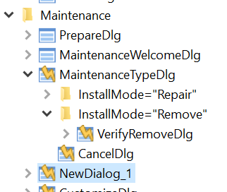

also can I create dialogues for uninstall process only?
Yes, you can do that by creating the dialogs under "Maintenance" in the "Dialogs" page:

Also will it be possible if I want to show user a dialogue at uninstall that will ask user that if they want to remove postgres only if they installed it via my installer during install time. So in short how can I show a dialog conditionally during uninstall time
For this, you can simply add the dialog and then right click on it --> "Show only if" and input your condition there.
