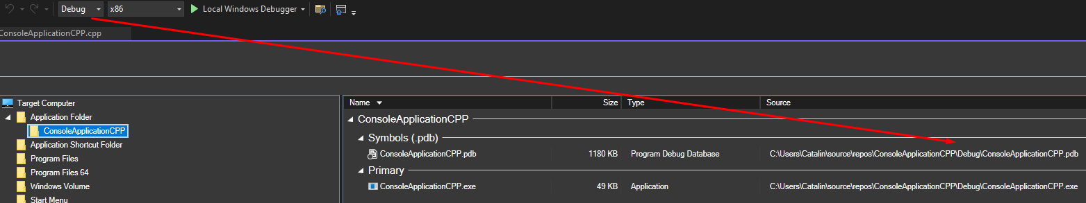

In my AI project I've created two build: Release and Debug. I've linket at Visual Studio 2022 the AI Debug with VS Debug and AI Release with VS Release.
This definition is important because in the VS Release i use an obfuscator, so I need to create an installer for debug scope and a Release setup with the production bynaries obfuscated.
This AI configuration is complete for my scope or i have to duplicate the binaryes for a Debug Features and Release Features and link them to Debug build and Release Build respectively ?

If possible, could you please give me some more details (perhaps some screenshots of your configuration) so I can better understand and assist you?

I,ve a vs2022 project and when i compilerò in release mode the binaries are dotffuscated. Using the AI plugin for VS i put the project"s output to the APPDIR but and i see that the file are resolved from the debugging output folder of VS, so if i have to build once with debugging binaries and then with the release ones, i've do something in AI or if i compile the AI project, it automatically get the correct binary source ? Ba,sed on the VS release or debug selection ?

The files are added accordingly with how the Solution Configurations are set, either Debug or Release.
