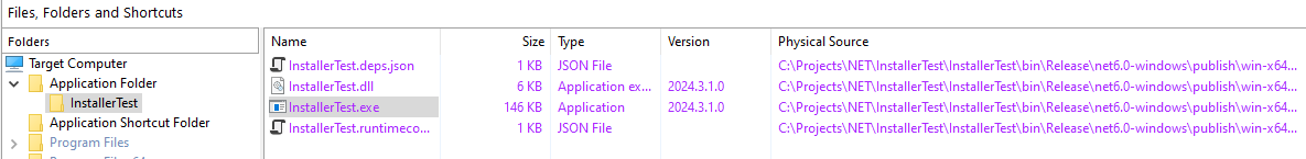

I also just noticed when I open the setup project in AI desktop, the 'old' version is what is shown:
