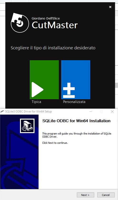

Hello to everyone!
I searched for this topic but i didn't find out a solution. I'm a noob about advanced installer so i'm sorry for some stupid question!
I'm building a installer with a simple exe file and some custom actions based on power shell command (copy a file from a location to another and another one who create an ODBC connection). For using the ODBC connection i need a specific driver that i want to install by the main installation built with advanced installer.
The main problem is that for every version the system call the installation while i want to call this procedure only if the software is not already installed. If anyone exit the installation of driver i want to quit all the main installation.
Sorry for my english! hope someone got my point! attached some file.
Thanks!
2024-03-25 20_13_28-.png (79.76 KiB) Viewed 20985 times

Ok i tried to set a prerequisite but i found two things while i try to install:
1. I have a new button with a custom insallation while i need just a one (wihtout custom)
2. even i click to typical installation it runs the driver exe even i already installed

Re: Install attached file (exe) only if not already installed
From what I can see, you are trying to look in the 64-bit version of the Program Files folder.
By default, this search will be redirected to Program Files (x86) if your setup is of 32-bit (you can check this in the "Install Parameters" page).
That being said, please make sure the search is marked as "64-bit" in the "Prerequisites" page --> "Condition" tab.
