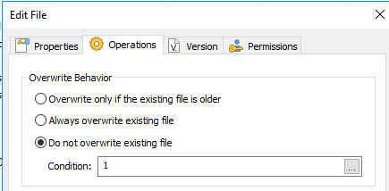

We upgraded to 21.5 from 20.0 and we are seeing a difference in behavior. We have a file that is set as not to overwrite during installation (upgrade).
settings on file that are not to be updated

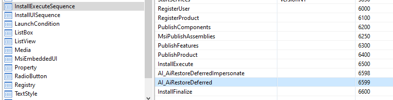

If you own an Enterprise license or above, we can check this by going to the "Table Editor" page --> "InstallExecuteSequence" table --> click on "Sequence" so we can order them.
After doing so, please check for your custom action and then look where it is scheduled in comparison with AI_AiRestoreDeferred action.
As we can see, this custom action is executed basically last in sequence, so chances are it will be executed after your PowerShell custom action.

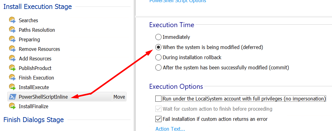

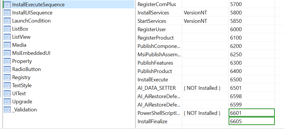

This is our current order. The highlighted line is the custom action that fires that modifies the file. The one thing that we did do during the upgrade is we moved from having the custom powershell script go from inline to an external file that we call. In fact we moved all our custom actions from inline to external scripts so we could modify our project without having to go into AI all the time. Could this be the reason? If so do we change the sequence numbers manually?

And sure, we can modify the sequence number so we can fit our custom action in there.
For instance, we can increase the value of InstallFinalize from 6600 to 6605 and then have our custom action with the sequence 6601.
Our custom action should still be scheduled during the "Deferred" stage

Changing the sequence order in the Table Editor allows us to modify the file on disk and gets us past this issue. While I consider this solved, it will be a pain going forward for any engineer learning AI that they have to use the Table Editor for anything touching files that are set not to be overwritten.
