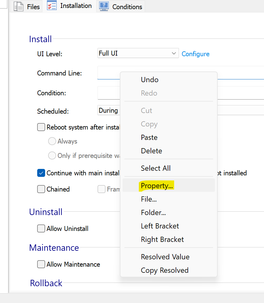

Re: SQL Server installation username and password
To be able to select a property reference you should just right click on "Command Line" field and select the "Property..." context menu option.
For any further questions or doubts feel free to write us back.

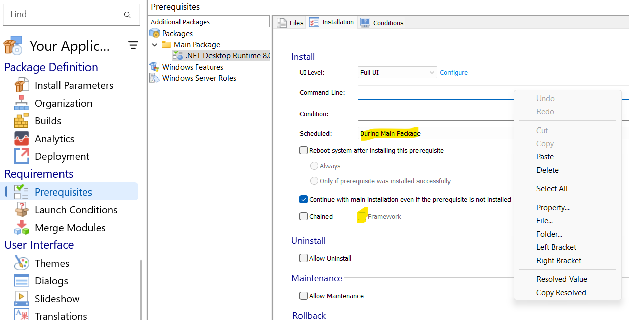

Right click gives me ....
To be able to use property references your prerequisite item should not be marked as framework and it should be installed during main package.
This is because framework prerequisites are installed before main package and during this stage the installer properties are not available.
Thus you need to uncheck the framework option and configure your prerequisite to be installed during main package.
Let me know how this works now.
Thanks for this information however I was following your tutorials on how to install SQL Server as a prerequisite. I removed the installation of .Net Framework and then un-ticked the Framework selection and the option to add a property from the drop-down menu appeared as in your screen capture.
