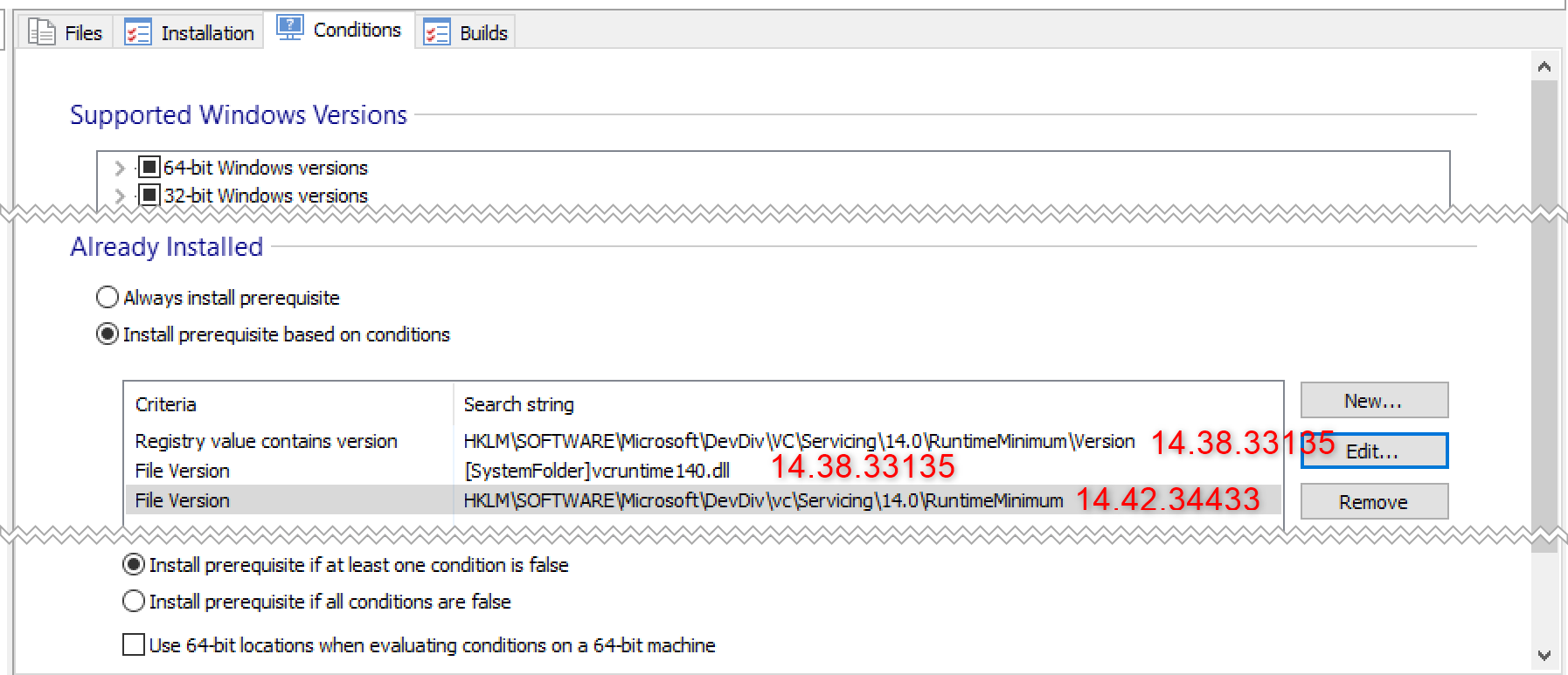

Hello Catalin, happy new year, and thank you for your reply! Your suggested command line works, but now I am a little confused. As you can see from this screenshot, it added a third install condition. The top two conditions, with value 14.38.33135, were present before I applied the command.
I wonder, should I delete the second condition, and maybe the first condition too?
Hans

I found a solution. I am posting this here for reference. Or maybe someone finds a more elegant way...
Since the prerequisite has two conditions (I don't know why, but this is how AI created it), I issue two UpdatePrerequisite commands, one for each condition. (See screenshot in my previous comment.)
The command to update the "Registry value contains version" is:
advinst.exe /edit "my_project.aip" /UpdatePrerequisite "Visual C++ Redistributable for Visual Studio 2015-2022 x86" ^
-minversion "14.42.34433" -prereq_path "<path>\VC_redist.x86.exe" ^
-search_type RegValue -search_path "HKLM\SOFTWARE\Microsoft\DevDiv\VC\Servicing\14.0\RuntimeMinimum\Version"
(The carets "^" at the end of line are line continuation markers which I inserted for readability.)
The important difference to Catalin's suggestion is that I uppercased the "VC" registry key component. Case and spelling must exactly match the value stored in the *.aip file.
The other command updates the "File Version" condition:
advinst.exe /edit "my_projct.aip" /UpdatePrerequisite "Visual C++ Redistributable for Visual Studio 2015-2022 x86" ^
-search_type FileVersion -search_path "[SystemFolder]vcruntime140.dll"
That's it!
