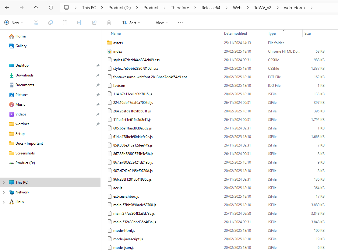

I´m attaching our .aip file that was working fine so far, please take a look at the
IIS WWW Root\TWA\eForms
synchronized folder (screenshot)

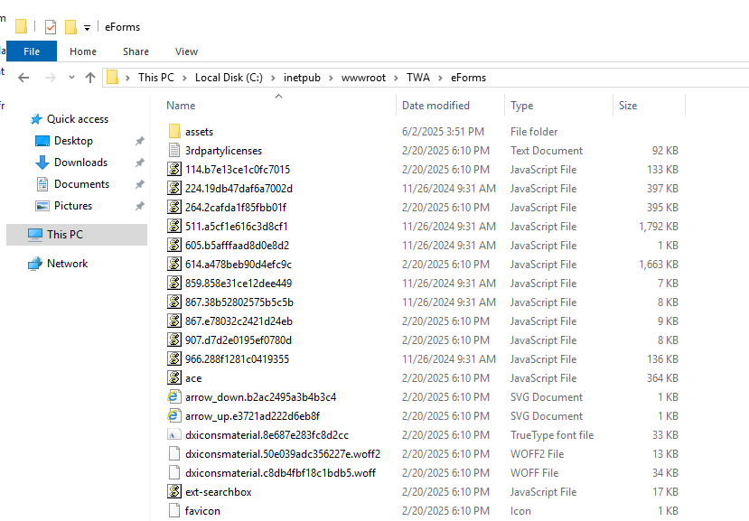

Its source folder contains a lot of files, until we used AI 19.7 the installation went fine, and the desired files were installed into
inetpub\wwwroot\TWA\eForms
folder. (sceenshot)
After we upgraded our .aip to use AI 22.7, this "feature" stopped working for us: if we create a new .exe with AI 22.7, the
folder stays empty, although we select the relevant feature of course.
