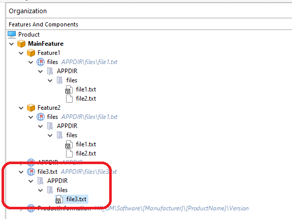

Multiple features use the same component with a synced folder
I have created a test project
TestProject.zip
(3.28 KiB) Downloaded 198 times

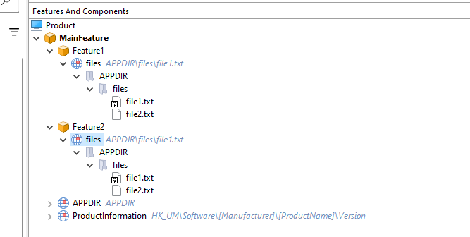

It contains two features. Both features use the same component, which is synchronised with a folder.
When I add a file called ‘file3.txt’ to the ‘files’ folder, the new file is recognised when I open it. However, it is now added as a new component in the root feature.
However, it is now added to the root feature as a new component.
I would have expected this file to be added to the ‘files’ component and therefore only installed when I install ‘Feature1’ or ‘Feature2’.
What am I doing wrong here, or do I just understand the basic behaviour of features, components and synchronised folders differently?

Hello Rene,
What I think happened here, from what I observed in my testing, is that we reached quite a corner case. :D
Normally, since all files have the same extension, they will be added under the same component as per the "Best suited component" option.
However, in this specific scenario of yours, we have modified the tree quite a bit (e.g. we shared the component between multiple features, etc.).
A possible fix, although not sure how much that would help, is to remove the files and then refresh the sync. This will add all the files under the same component.
The downside of that is that the order you previously had will be lost (e.g. the component will no longer be shared between Feature1 and Feature2). We would have to share it again.
I will try to think of another way, perhaps some automation we can do to avoid this and will let you know if I will find anything.

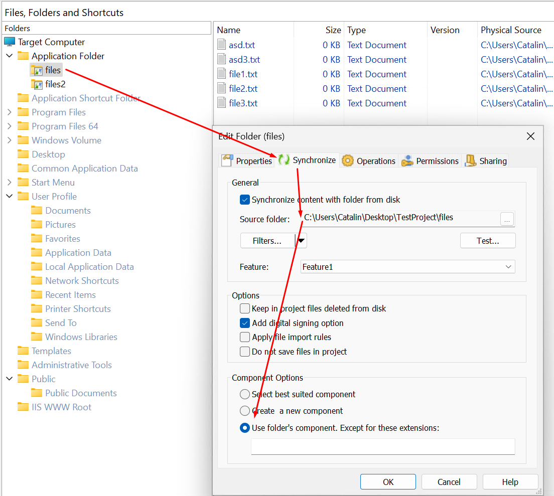

The problem here, I think, stems from the fact that you have the synchronization done under "MainFeature".
We would need to have the synchronization done for each feature.
Here is my proposal:
Instead of 1 folder, have 2 folders that are both synched with the same folder from disk.
For each folder, we should have the "Use folder's component" option. And each folder should be tied to its feature (e.g. "files" folder to "Feature1" and "files2" folder to "Feature2").
Could you please try this and let me know if it helps?
