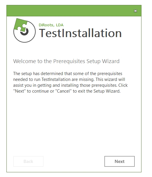

When attempting to uninstall the main tool after its prerequisite has been removed, the system incorrectly displays the "Installing prerequisite" window. This is misleading and suggests that installation is occurring during uninstallation.
Steps to Reproduce:
1. Install the main tool along with its prerequisite or skip the prerequisite installation using Condition in the Prerequisite Installation Tab.
2. Manually uninstall the prerequisite, if it is installed
3. Attempt to uninstall the main tool.
Observe that the "Installing prerequisite" dialog appears during this uninstallation process.
Expected Behavior:
Uninstalling the main tool should not attempt to reinstall or show installation prompts for a missing prerequisite.
Actual Behavior:
A misleading "Installing prerequisite" window appears, suggesting that the system is attempting to reinstall components during an uninstall operation.

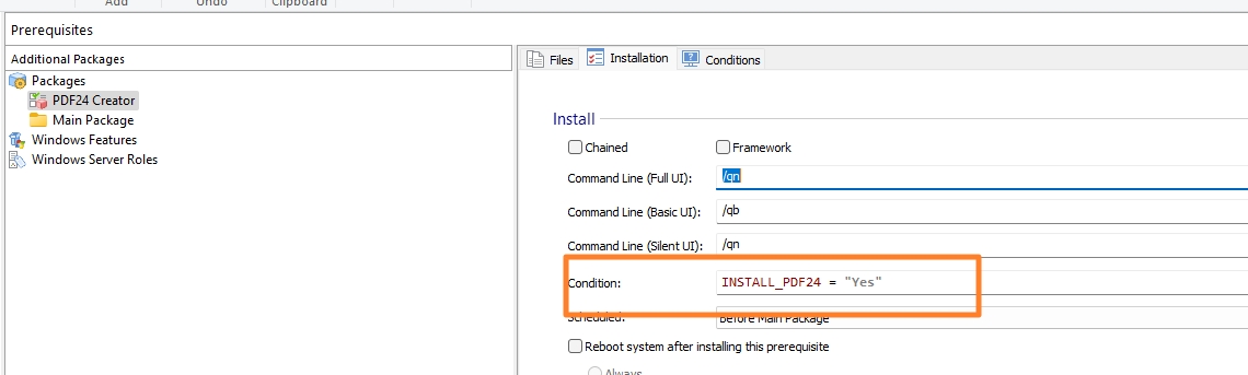

Re: Incorrect Prerequisite Installation Prompt During Uninstallation
The problem with the prerequisite is the fact that you are using a wrong condition.
In the "Dialogs" page, you can see that the value of the checkbox is "CheckBox" if it is checked.
Regarding the other error, I was not able to reproduce it by changing the prerequisite's install condition to a correct one.

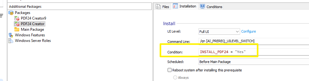

This turns out to be caused by the use of wrong conditions.
Could you please try to use the following condition for your prerequisite:
INSTALL_PDF24 = "Yes" AND (NOT Installed)
and let me know if that helps?
Even though the prerequisite is not installed, I still receive this message in the progress status
Even there are status updates about the prerequisite during uninstallation

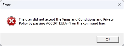

At the end of the process, I still get this window—which should only appear if UILevel = 2 (onle for silient mode)
Thank you for sharing the resources with me.
I have tested this, but I'm afraid i wasn't able to reproduce the issue on my end.
I do not see any messages during the installation with full UI. However, I can reproduce this if I launch the EXE with the /qn parameter, which is correct considering the condition you have used.
Are you able to reproduce this on a clean VM as well?
