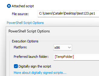

The basic steps are very simple. Have a PS script attached to the installer, set it to run from the temp folder, mark it to be signed.
Have a custom action to execute external PS script.
When the dialogs come up, before clicking the 'install', go to the temp folder and tamper with the .ps1 script file (like change a variable name).
Proceed with the install. It will continue and will execute the CA with the tampered with .ps1 file.

A quick followup on this as I'm note quite able to reproduce the issue on my end, due to the fact that I'm not able to locate the script.
Here's how I configured the custom action:
In your case, you mentioned that the script is in %temp% folder before pressing the "Install" button, but this does not seem to be the case for me.
That being said, are you sure you did not miss a step perhaps in the test case?
