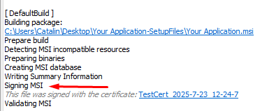

Note: the signing process should appear in Advanced Installer as well, when you build your project, e.g.:
Does it appear that way for you as well?

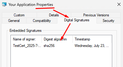

Another way of checking is after the build, in the file's properties --> "Digital Signature" tab.
