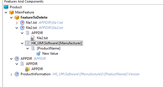

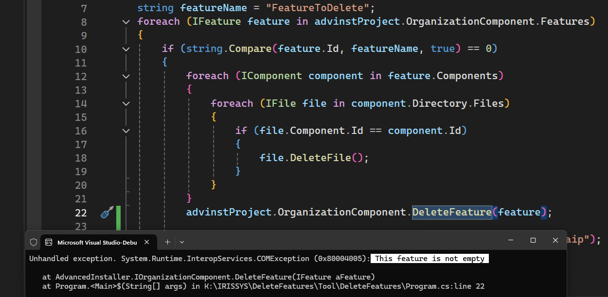

Before building, we customize the project and remove some features if necessary. We use a C# program for this, which is supposed to remove the feature via the COM interface of AdvancedInstaller. First, all file components of the feature are removed, and then the feature itself. The problem is that we have file components that are also linked to one or more registry values.
However, I cannot find a way to determine these values via the file component and therefore cannot delete them. When I try to delete the feature anyway, I get the following error message.
Attached (

I’ve tested this and it appears that there’s currently no way to determine which component a registry key belongs to, so we cannot delete it later from the Registry.
However, I’ve added this improvement to our TODO list, and we plan to include component information for registry keys in a future version of Advanced Installer.
