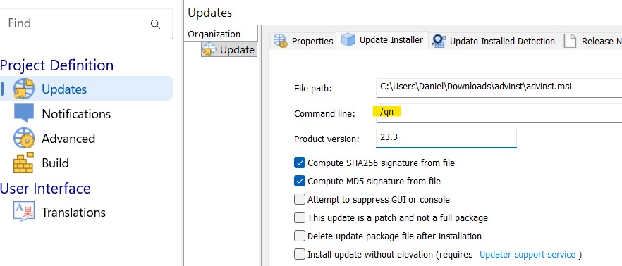

Usually the updater process hangs when launched in silent mode if the updates setup is not launched silently too. For instance when the updates setup is launched with full UI.
Can you please make sure you are using a silent install command line (i.e. /qn) for your updates installer in your updates configuration project? And then test again the scenario and see if this helps?

Unfortunately adding command line arguments to the update project didn't resolve the issue. I still see one of the updater hanging. The only difference is now it doesn't have a child msiexec process. Is there a way to see logs from updater.exe when its launched via scheduled task?
