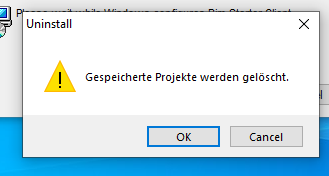

I managed to found a solution. I used a custom action with inline VBScript.
Go to Custom actions - Add Custom Action - Search Predifined Custom Actions - write "Execute inline script code" - "Add with sequence".
Drag the icon "ExecuteScriptCode" before the point "Searches" in the "Installation Sequence" panel.
Click at the "ExecuteScriptCode" line to show its settings. Set:
- ActionData: your custom title, for example "Uninstall_warning"
- Script type: Visual basic script
- Execution time: Immediately
- Execution stage condition: uncheck "Install" and "Maintenance"
- Condition: REMOVE="ALL"
Script:
MsgText = "Saved projects will be deleted. Save your files before continuing."
If Language = 1031 Then
    MsgText = "Gespeicherte Projekte werden gelöscht."
End If
Result = MsgBox(MsgText, vbOKCancel + vbExclamation, "Uninstall")
If Result = 2 Then
    Session.Property("STOP_INSTALL") = "1"
    Err.Raise 1602
End If
Maybe later I'll try to use Dictionaries instead of "If Language". And also AdvancedInstaller says that VBScript is deprecated, so it would be better to rewrite the script with JavaScript (unfortunately I know only VB).
But I'm already happy. Everything works exactly as I want.
