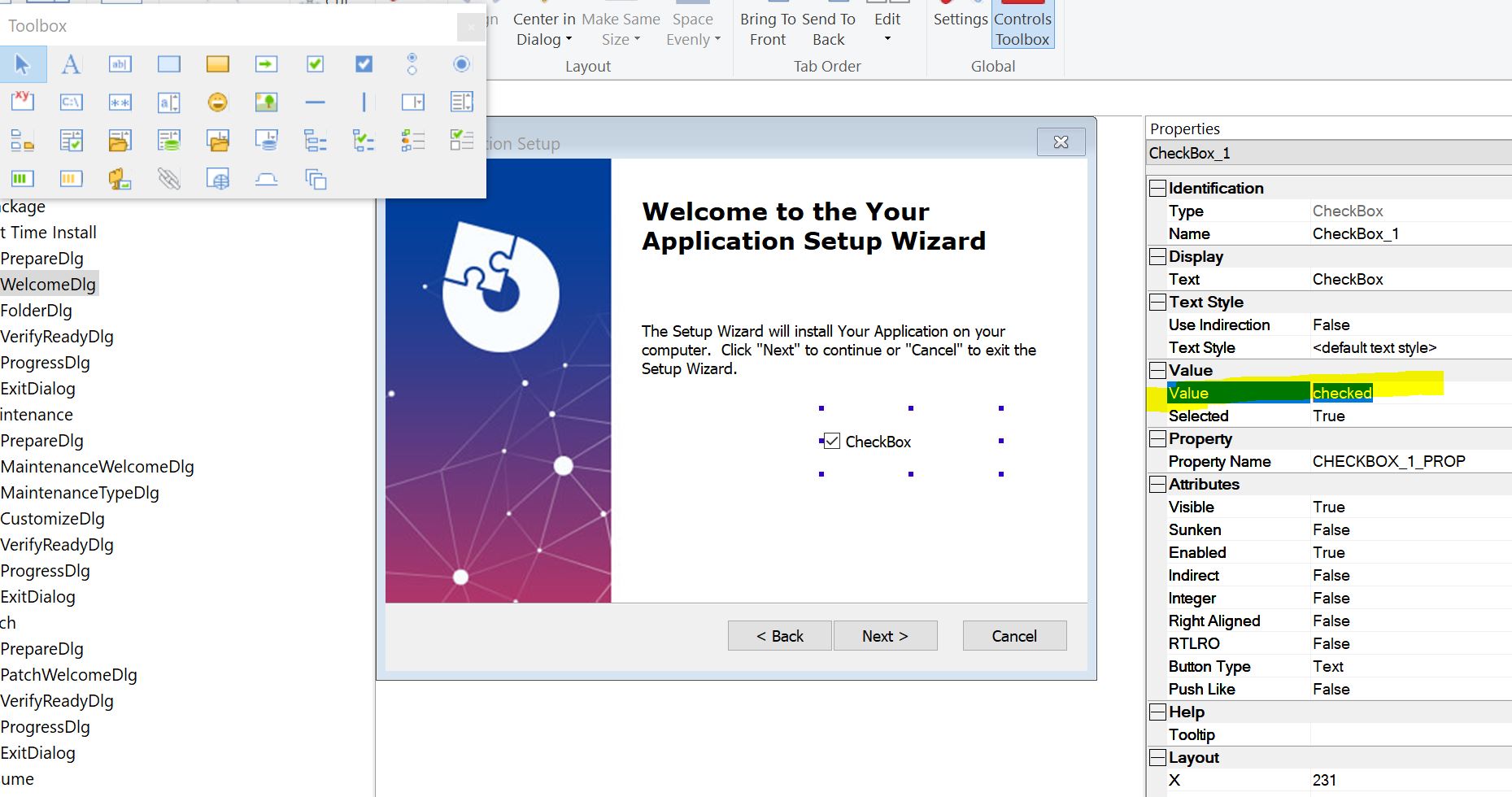

Re: How to get the value of the checkbox
Please note that when a checkbox is ticked its property is set to the string you set in the "Value" field from "Properties" right pane.
When it is not checked, then its property value will be set to empty string ("").
So you should check within your script if statement that the property value is equal or not with the string set in the "Value" field from "Properties" right pane.
Hope this helped.
