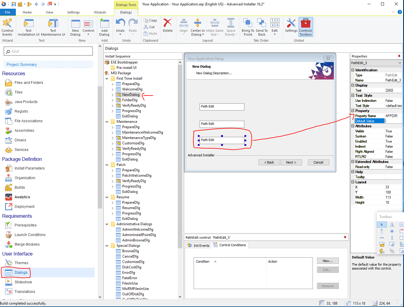

In what regards this, please keep in mind that, by default, the Path Edit control has the APPDIR property assigned to it. The reason why this does not work is because one of your controls is overwriting the other one.
Here is a quick explanation so you can better understand:
Property - Properties are global variables used by Windows Installer during an installation. Their values can be set by the operating environment or by authoring them into the installation database.
Almost every control has a property assigned to it. This property is useful to further use the value saved in it. For instance, an edit box is used to let user input data during the installation time. If the user wants to access that data during the installation property, he can do so through the property which stores what the user did input in the edit box.
By default, in Advanced Installer, you can find the Path Edit control in the "FolderDlg" dialog. Its assigned property is the APPDIR property.
The APPDIR property represents the path of the "Application Folder" in the "Files and Folders" page (it is usually the main installation folder).
Now, going back to what we have discussed earlier. If on your newly created dialog, you add two Path Edit controls, they will have the property assigned to them set to APPDIR by default:
This means that, when you set one of the Path Edit's default value, all the default values will be changed since they do share the same property.

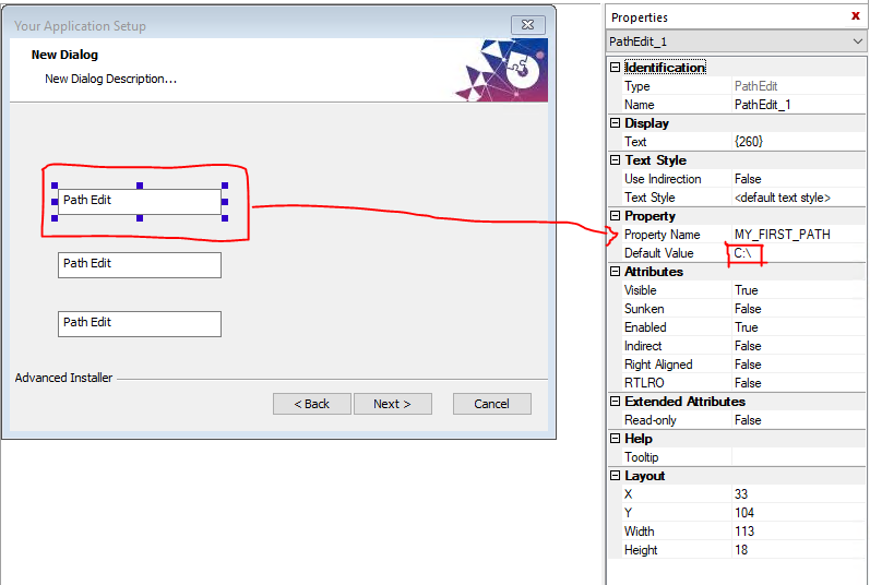

A workaround for this problem would be to change the property assigned to each of your Path Edit controls.

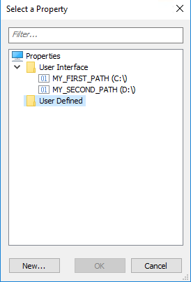

This can be done by going to "Dialogs" page --> select your dialog --> select the Path Edit control --> on the right pane, change the "Property Name" field from APPDIR to anything you desire, for instance: MY_FIRST_PATH.
Accordingly, you can proceed in renaming the property assigned to your other controls.
Here is an example of how all of this can look:
After doing so, upon installation, the dialog should look like this:

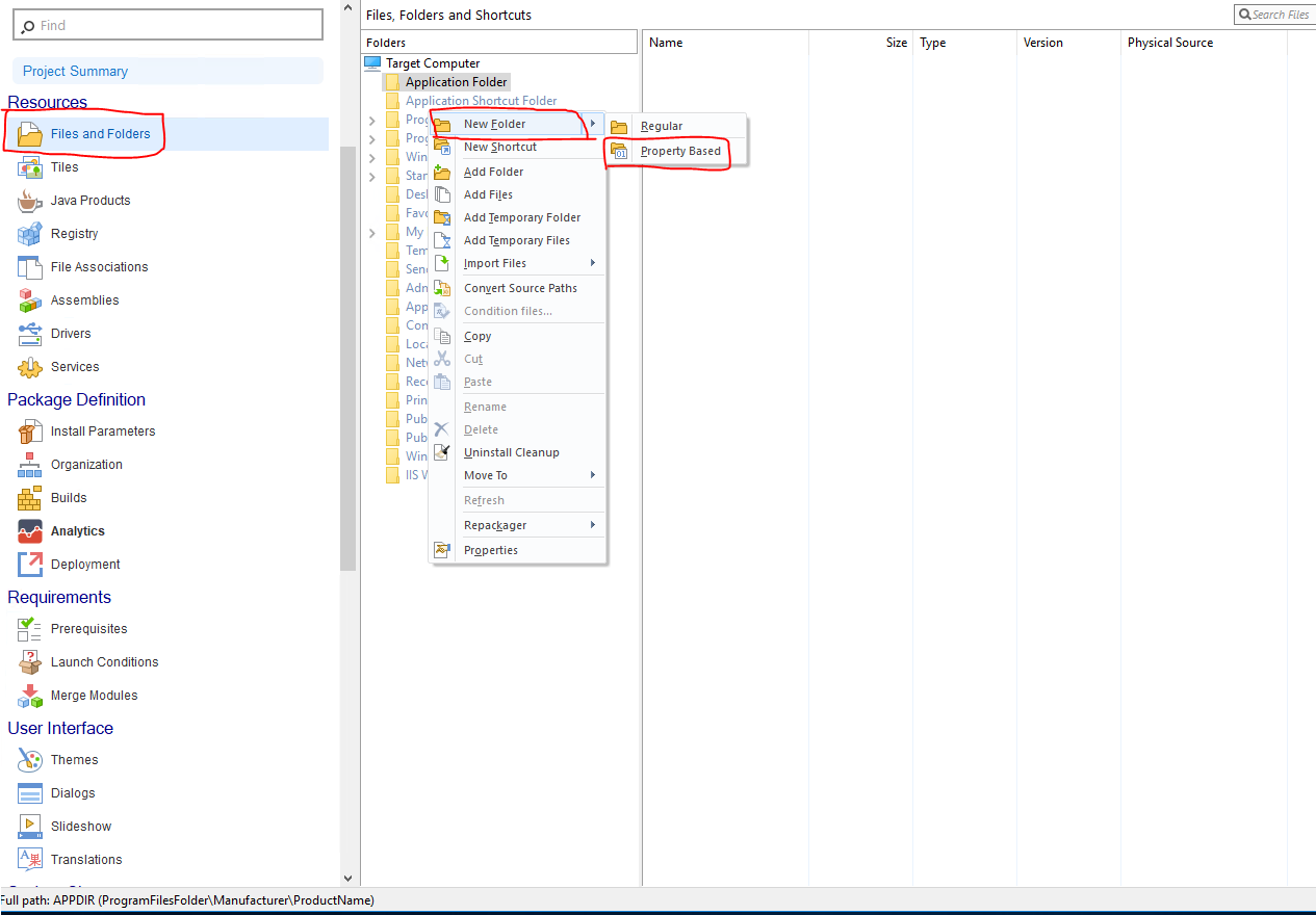

If you want your files to be installed in the path saved in those properties, you can simply create a property based folder. A property based folder is a folder whose default path is a property's value.
For instance, the "Application Folder" from the "Files and Folders" page has the default path of the APPDIR property (which is "C:\Program Files\Your Company\Your Application" by default)
In order to create a property based folder, you can proceed as it follows:
1. go to "Files and Folders" page
2. right click --> "New Folder" --> "Property Based"
After doing so, the "Select a Property" dialog will be spawned, asking you to select the property which should be assigned to your folder. If you expand "User Interface", you will be able to find the earlier created properties there.
