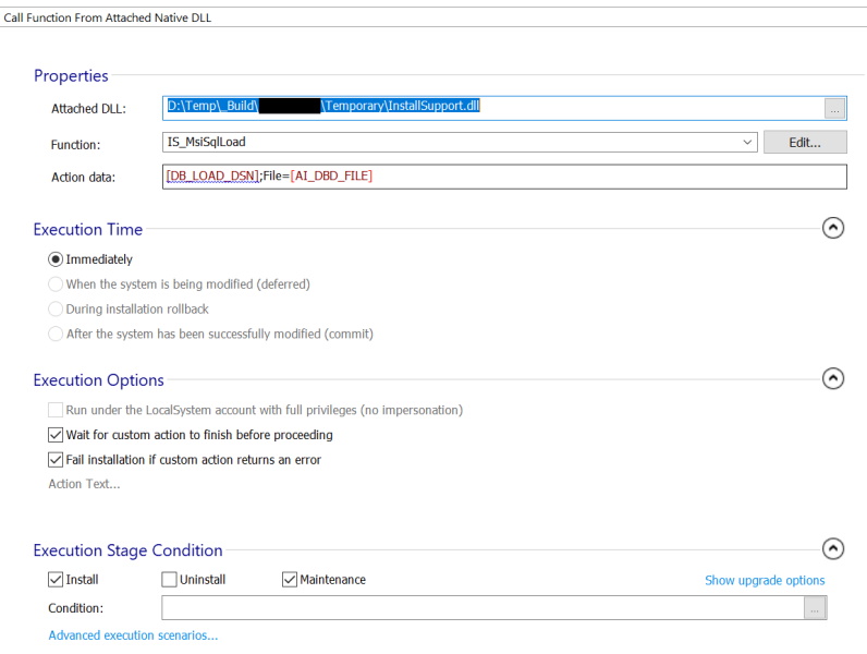

My second custom action (LoadDatabase_Cost) is also exported from a DLL written in C++. It is executed via the "Call Function from Attached Native DLL". It loads a SQL database from data in a custom file form at we use here at the office. It needs to be passed a SQL connection DSN (the value of DB_LOAD_DSN) and the file from which to load the data. I have it configured as follows:
As you can see from the above screenshot, the Action Data is [DB_LOAD_DSN];File=[AI_DBD_FILE]".
The custom action is scheduled as follows:
When the install runs, the LoadDatabase_Cost receives the following data. Notice the value of DB_LOAD_DSN is missing (it should be before the semicolon):
;File=C:\Users\ADMINI~1\AppData\Local\Temp\2\TestProduct\Data.dbd

If possible, could you please provide, by email at support at advancedinstaller dot com, a sample project that reproduces this behavior (a project that I could build on my end)?
Although I understand the fix (by adding the property in the Properties table in the Table Editor page), I'm afraid I wasn't quite able to reproduce the initial issue described by you.
