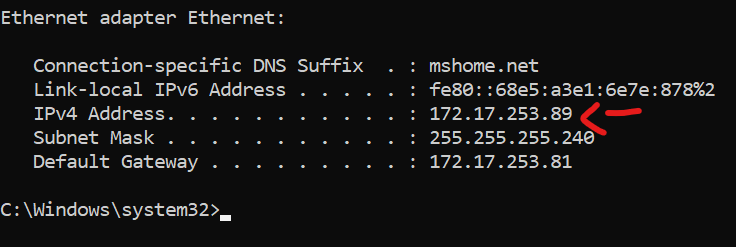

In addition to the below, would it be possible to assign the IP address to the IP address of the machine that it's installing from? Thanks.
In order to achieve this, you can create a custom action that takes the IP address from the machine and then store it in a property. After doing so, you can use that property in the "IP address" field.

Re: Website binding with a hostname
Hello Hien,
Here is the article I have mentioned in my previous thread.
Local IIS Website - automatic IP assignment to Hostname
Hope that will be of help for you!
So I gather that Advanced Installer doesn't map a hostname with ip address during the install? And this step needs to be manually done?
Advanced Installer does that.
However, in case of locally installed websites that are not available on the internet just yet , the "hosts" file will also need to me modified. Normally, a website that is available on the internet will have its hostname and ip address binding by the DNS.
