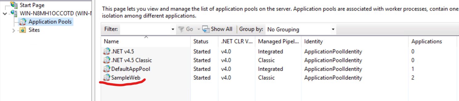

Re: AI_IIsConfig: Advanced Installer is unable to access IIS during installation on Windows 2019.
Hello Kashif,
Thank you very much for the provided project.
I have tested this on my WinServer 2019 machine and everything worked as expected.
Most likely, I would say that this issue is related to your Windows Server machine. Unfortunately, I am not an IIS expert myself, so I can not really say why this is happening, especially without being able to reproduce the issue.
I would advise getting the error from the log and trying to do some further research, perhaps you may find a solution.
