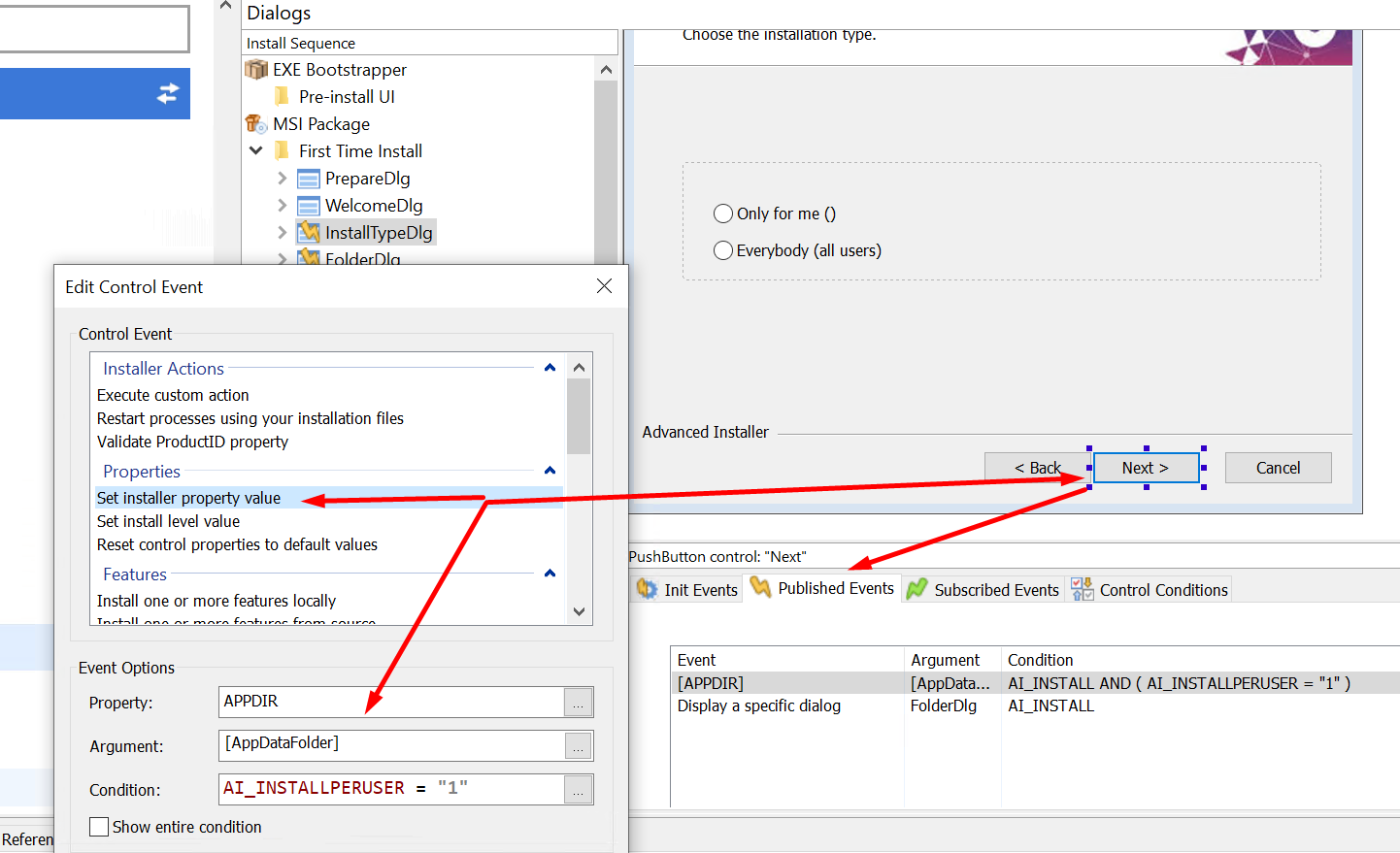

In order to achieve what you want, you can proceed as it follows:
- on the "Next" button of the "InstallTypeDlg" dialog, you can create a "Published Event" as it folllows:
This way, we will automatically set the path to %appdata% if the user selects the "per-user" option.

For others looking for the same solution, I slightly adjusted the argument as follows:
[AppDataFolder][Manufacturer]\[ProductName]\
This will maintain consistency using the manufacturer and product name. Optionally, some may wish to include "[Programs]\", before the manufacturer, to remain consistent with how some other applications install.
