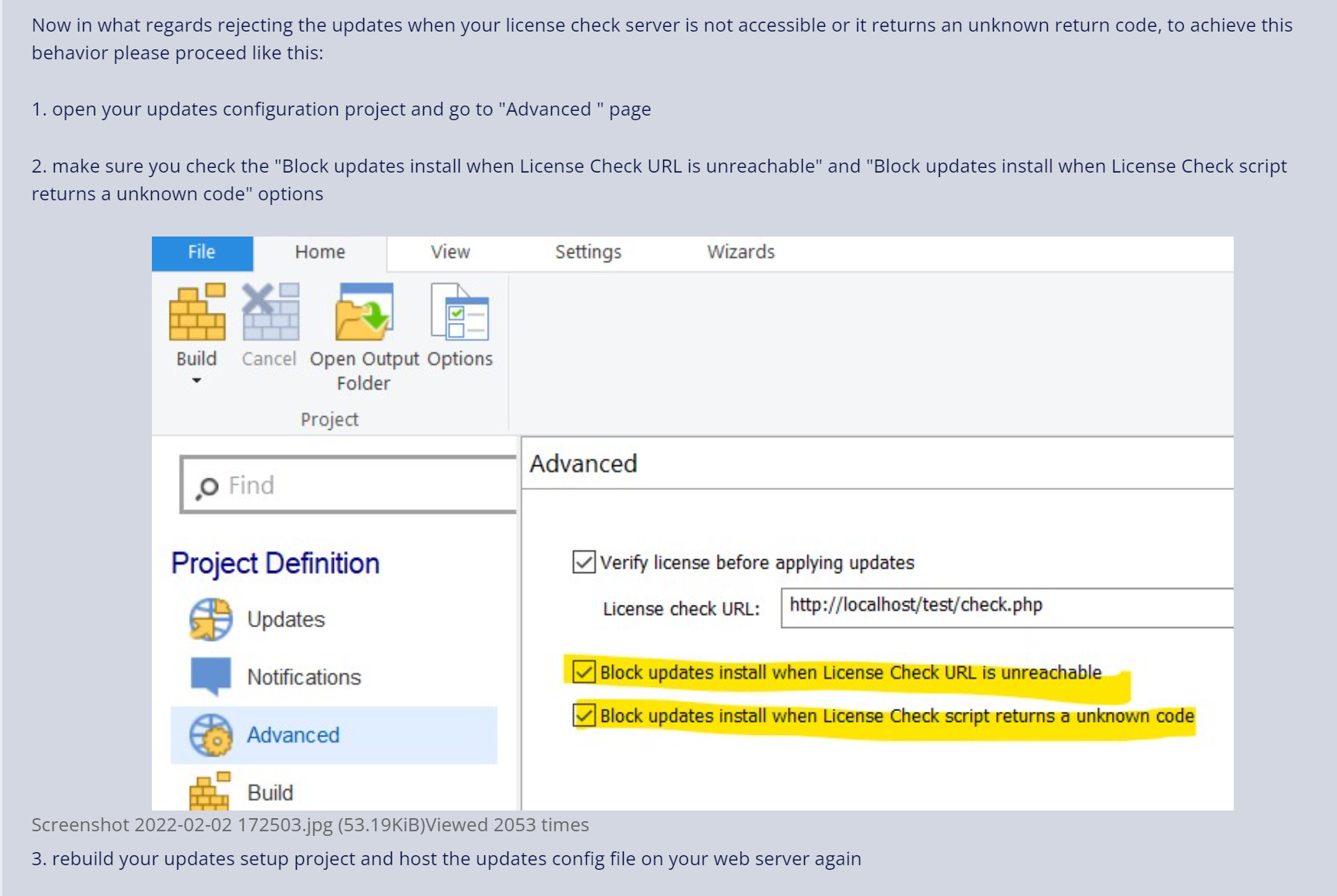

In the forum thread I've linked above, you can see that there are two options my colleague Daniel has highlighted:
If I understand correctly, this is what you want to achieve.

To be clear we are checking those two checkboxes, which is why the file has the tags
FailOnServerError|FailOnWrongRetCode
The tags do work correctly when updater is called with the reg key as an argument. They do not work when the updater is called without the reg key as an argument.
