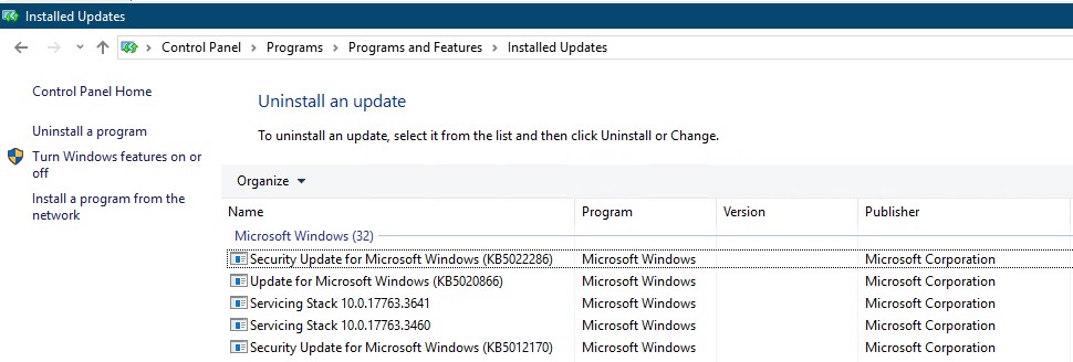

we have same error using "SetAzureKeyVaultSecret" command in .AIC file, using new v20.2.
We encountered the problem after a Windows security update named "KB5022286" (see attached image).
Security Update Windows - ERRORE su Advanced Installer 20.2.jpg (77.88 KiB) Viewed 36710 times
Let us know if you fix this issue this week.
Thanks, reguards.
