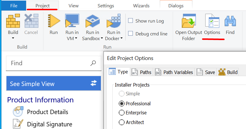

Please make sure that your project is Professional and not perhaps Simple.

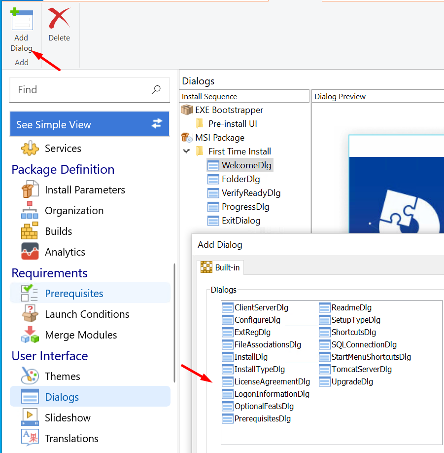

I followed your directions but I'm still not seeing the LicenseAgreementDlg in my options??? I also confirmed that I am using a professional license. See the two attached screenshots.
I started this project as a simple project, then it was automatically changed to Architect at one point. I manually moved it back to Professional because we didn't need any Enterprise/Architect functionality. Could moving the project between versions cause this? Here is the DOCUMENT line from my AIP file.
<DOCUMENT Type="Advanced Installer" CreateVersion="21.6.1" version="21.6.1" Modules="professional" RootPath="." Language="en" Id="{2C1F7A2C-21A7-4468-8165-EAA3CEC1DFD5}">
Thanks in advance!

Re: LicenseAgreementDlg not available? Professional License
@Catalin I just created a brand new empty Professional project and I see the LicenseAgreementDlg option like you mentioned. I'm betting there's something wrong with my aip file.
I took that new empty Professional project, upgraded it to Architect, then manually edited the aip file to move it back to Professional to try to reproduce the issue. I wasn't able to reproduce it though, the LicenseAgreementDlg is still there.
The only other difference I see is the number of "First Time Install" dialogs I have in my real project vs my empty one (and the one you posted screenshots for). I only have Welcome, Progress and Exit in my MSI package Dialog, whereas Folder and VerifyReady are in the projects where LicenseAgreementDlg is there.
